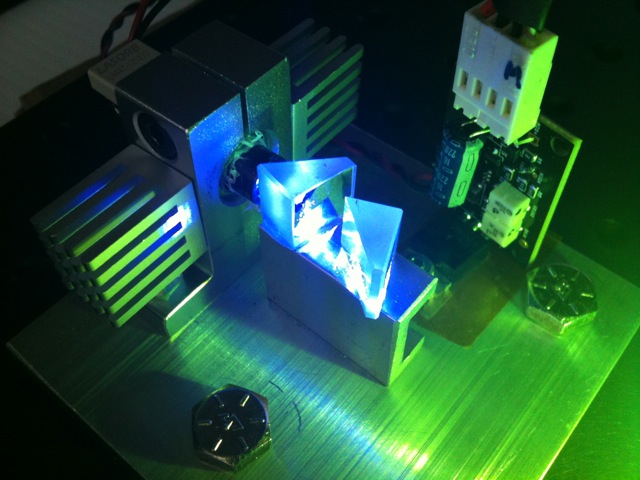

  10. #60
    A few more pictures of my Build and it then added into my projector. Sorry but no scanned shots as of yet as I have just coated my DT40 mirrors with first contact
    The beam shots will come later
