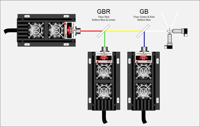

    Now for the optics... You will be mixing the beams from 3 lasers. That means you only need 2 dichros. As for which type of dichro you need, that depends on how you want to arrange the lasers inside your projector.
    A common arrangement is to have the green laser firing straight into the scanners, and then mix in the red and blue beams along the path of the green beam. In this case, usually the red is mixed in first (which means you need a pass-green, reflect-red dichro), and then the blue is mixed in last (which requires a pass-green-and-red, reflect-blue dichro). The reason for this arrangement is that blue photons are expensive, so you want them at the end of the chain, where they have to pass through the fewest optical elements. Here's a picture of what I'm talking about. (Ignore the pair of red beams at the top. They are combined with a PBS cube that is out of sight in this picture, and that's not something you'll need to worry about anyway. The beam path is what's important.)
    However, you don't have to use this arrangement. You could put the red laser first, and the green laser second. Then you would need a dichro that reflects green and passes red. (Exactly the opposite of the layout above.) Of course, the blue dichro would stay the same. Here is a picture (from Loopee's gallery) that shows this layout:
