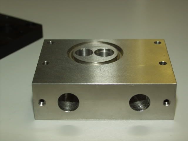

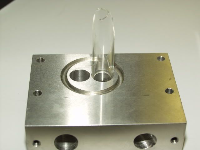

    I'm definitely not splurging for a cerium doped flow tube. This is a pulsed YAG head and I have a local glass blower that's going to cut and flame polish a 12mm Pyrex tube to my dimensions. I guess my only concern with the flow tube is that the Pyrex he uses is low grade and has some radical lensing to it.
    The flow tube appears to be nothing more than a channel for the inital flow of coolant. No seals or anything. By the time it gets around the rod the whole cavity is flooded. Never seen it done this way before but I guess it makes sense.
    As for the silicone, It looked like hardware grade clear silicone and was applied in a sloppy manner. No doubt this was the WRONG stuff.

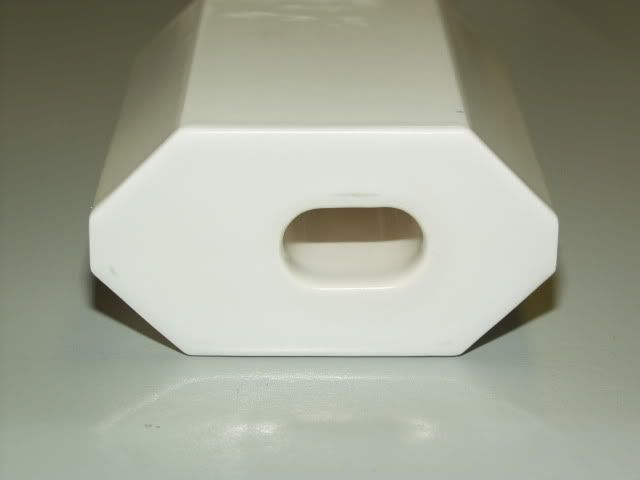

    My question would be what is the RIGHT adhesive for this job???? I just cant see fitting a small enough o-ring in here to get a proper seal.

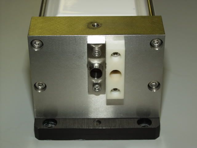

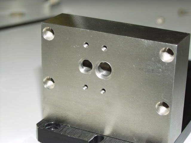

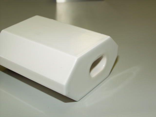

    Here are the full pics of the cavity...
