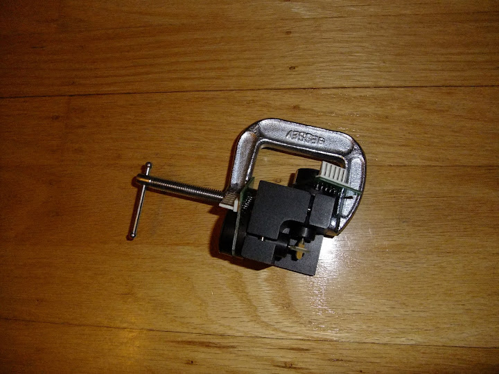

    anyone know if I can fit the DT40 Wide motors to the same mount block that came with my DT40 Pros? Removing the old one while I fix the amps for the Pro motors would make me very sad.
    They will fit but you wont be able to go full width as the wide scan block has a chunk milled out to match the conical end of the y scanner so if you go too wide you will just draw on the scanblock. But running narrow is better than not running

    Thanks! I measured it but it didn't look like it'd fit. I assumed the Wides would have the same motors as the Pros, but apparently they're different. Who's stupid? Me. (I am.)

    In fact, on actually trying it, they don't fit. :-(
    Crazy cos after you posted yesterday I tried one here to be certain and it fitted????
    How old are your DTs and are they for large beam mirrors or standard - not that there should be a difference.

    The DT40Pros are pretty old- a couple of years, and out of warranty (glork). The DT40 Wides are brand new.
    In the end I managed to remove the mount from the projector and replace it with the Wide block. And promptly stripped the thread on the X-galvo shaft clamp. (It seemed to be cross-threaded, as it was rather difficult to remove.)
    I am now super pissed.

    Thanks Jon, but we don't really have time to do this right now. I'm going to pick up a small C-clamp and jury rig it for now, and then drill and re-tap at my leisure (hahahaha like I have any leisure time).
