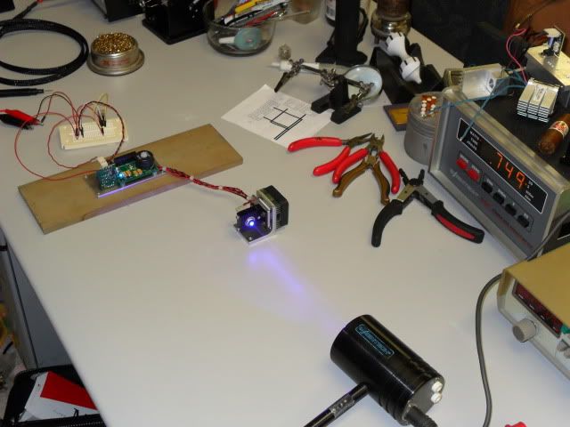

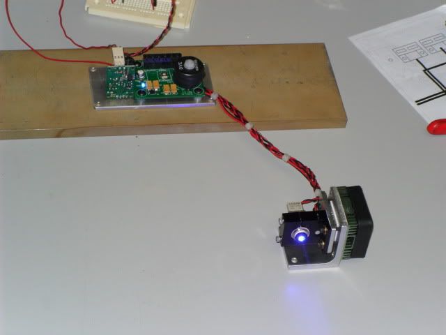

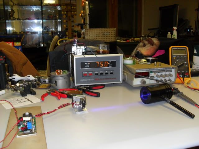

    UPDATE!
    It runs rock stable but the diode driver heat dissipation is a little too much for the TEC and heatsink. I've decided to go with everyone's suggestion and alter the design. Too bad, the driver fit so nicely in there.
    I'll post some more pics after the changes.

    Nice looking kit Adam but you still have steel bolts acting as a thermal bridge across the Peltier.
    Wouldn't it be better if the were nylon ?
    That way the TEC wouldn't be thermally short circuited !

    With all the hullaballoo...no one noticed what he used the little hole that I have been putting in the mounts since the beginning that everyone always ask me "whats that little hole for?" Plan ahead my friend...and he figured it out (i didnt tell him either)

    Hey Adam, looks nice. I can't help be think there is going to be some movement of the LD block due to heat expansion...
    This space for rent.

    Na, that little amount of feedback won't matter. If I needed to be that particular, I'd insulate it too. Ouch, I just had the tracking info, I'll have to look for it. It's around somewhere. I guarantee it's on it's way though.

    It works great! Pics shortly. The hole is the perfect size, placement and distance for the thermistor as well. The way I do it is inject thermal compound in the hole after the thermistor is placed and then cap off both ends with epoxy.
    Quote Originally Posted by dnar View Post
    Thanks! No, I don't think I'm going to have an issue there. This is how the pro's do it.
