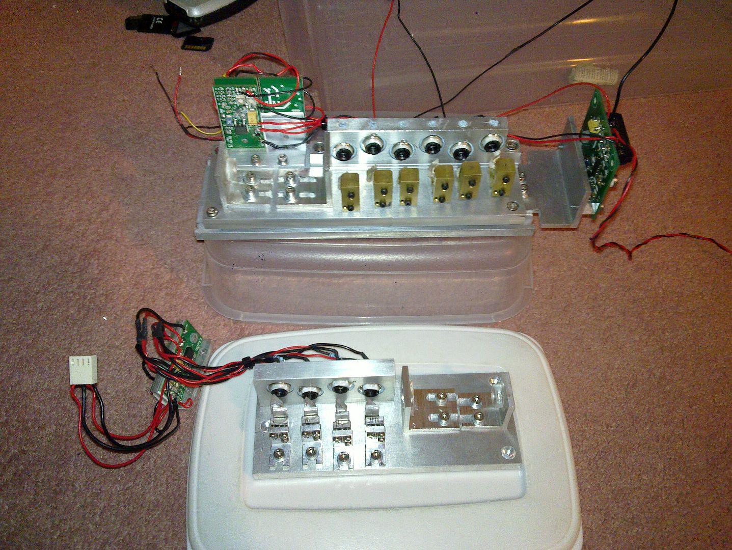

    Smile combiner
    what are you using to bring all tose beams together and make them smaller thanks and God bless.
    needs a little bit of tweaking as i can get a slightly better beam but you get the idea
    God Bless.

  4. #84
    my collection of reds is growing...
