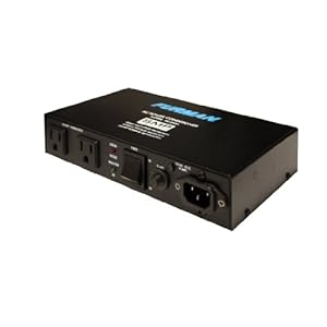

    I thought of 2 solutions....the first one I like the best cause it seems easiest...
    http://www.furmansound.com/product.p...id=AC-215A_PRO
    That would be installed in the projector...
    Or something like this.....(obviously not installed inside projector)
    http://www.labsafety.com/APC-Back-UP...sredirect=true
    What do yall think about the levels of protection these devices offer? What would you do to save your laser from an early fiery death......?

    the second solutions looks best for me, i'd go for a good quality on-line UPS and be done with it

    I use those Furman 215's pretty regularly. NEVER had a single problem with them nor any power issues with anything connected to them. Then again, I do not recall powering any of those things from generators.
    my $.02
