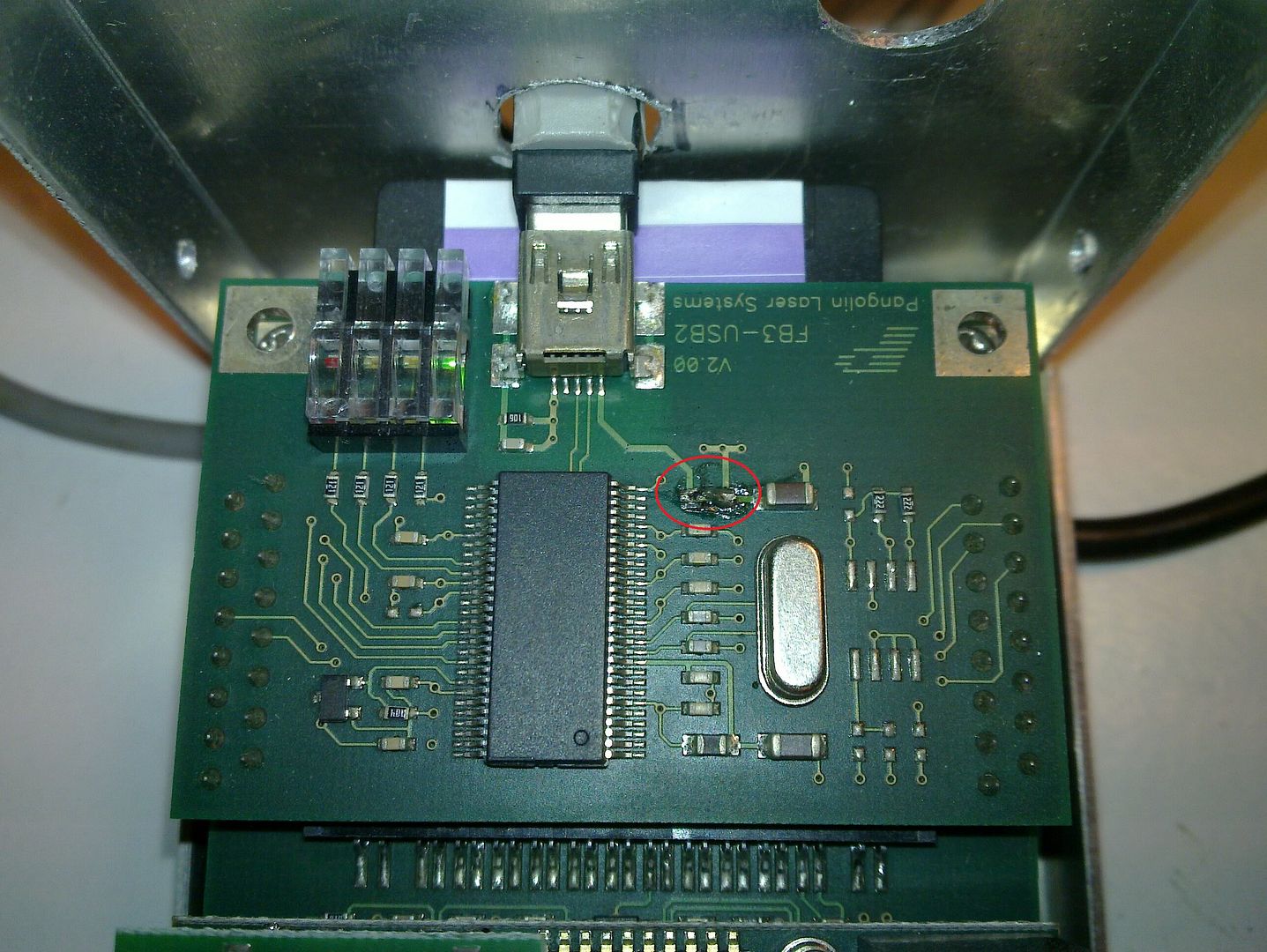

    If it is in a box it is an XE, if it's a bare board, its an SE. Both can run on USB power as they are the basically the same board.
    There is a small pair of holes which need to be bridged in order to run on USB power. The best solution is to add a pin header and you can switch on/off usb functionality with a jumper as needed.

    From what I have seen both the SE and XE are sold without an enclosure; we only have the SEs at the office currently. The QS is the only one I have seen with an enclosure. Norty is correct about the pin holes to be jumped for USB power; it is how we test them. You may want to see what it will take to swap the unit out for a QS model if you don't want to try to build an enclosure yourself. If you have any problems hit me up and I'll see if I can assist.

    you can mod the board with a simple jumper connection so the FB3 will use the primary USB connection as the power source.
    If you need to go that route, PM me -
    I have a photo of my board that was labeled by some guy named Bill at Pangolin that shows exactly where to make the jumper connection...

    Or, since Andy beat me to it - see his photo!!

    Also, is it right that Andy's version is a very early one without the holes, which is why it's bridged where it is?
    This is my SE from a few years back
    Frikkin Lasers
    Where you have it circled is where we put a jumper to use USB power for testing.
    I believe you are correct -
    My board ('07 model) looks just like Andy's, and that is the location Bill said to bridge for USB power.
    He also sent the reminder to disconnect any external power connections if making this mod, so you don't create issues with two power sources to one card...
