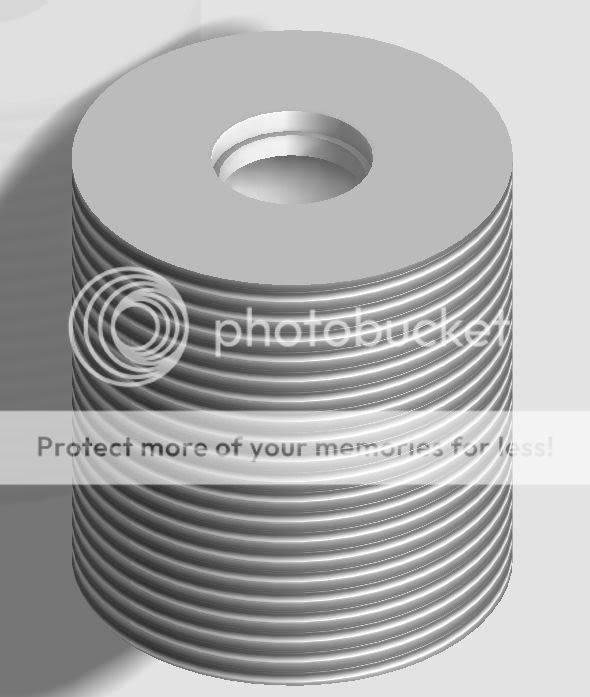

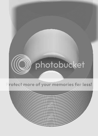

    Are Dave's lenses mounted in a threaded aixiz-type lens holder?
    (oops , didnt see your post there planters, we musta posted at the same time .. )
  3. #813
    MI, flint, farmington hills
    569
    Yes he posted an image.
    It is just a simple glue in style lens holder.
    m9 05 threaded with a 3.3mm D 0.5mm deep depression for the lens and then a 3mm hole roughly for the beam to go threw then on the other side a 6mm hole going all the way back 1mm away from the depression lip. over all length is about 10mm.
    I can post a 3d image of it in a few min.

    hey dave is that us or au $$ for these lens , and does the lens come mounted in the retainer ? dont think i fancy gluing somthing that small
  9. #819
    569
    You must glue them yourself.
    these lenses are to small for any other decently priced way.
    Daves design is not hard to glue i did mine with no problem
    The lens does not sit all the way in the hole there is a good exposed edge that you just slide the glue against.
  10. #820
    Northern Indiana
    921
    ^second that. Not hard to glue at all.
