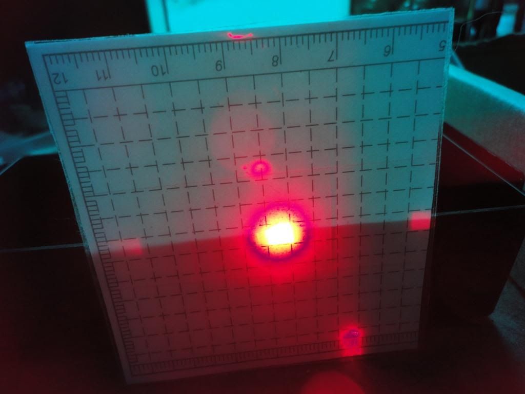

    Quote Originally Posted by andythemechanic View Post
    Hi Solarfire,
    how do you measure beam size?
    When I measure your far field image with imageJ under the asumption that your camera is linear and that the squares are 1mm I measure 41mm 1/e^2 slow axis beam size, see attached screenshot.
    The theoretical limit with the lens combination and emitter size of this diode is 31mm so your result is still improvable ~30% using better lenses. This then corresponds to2.8mrad full ange 1/e^2 divergence.
    Ot to put it in other words: 1. Beam parameter product is a constant 2. With their BPP this diodes are still not very usable for showlaser use.
    Sorry to be so negative here, but it always kicks me how much it is tried to beat the laws of physics here. I am watching this thread the whole time and to be honest: this diode is not the holy grail and will never be. In terms of Power/BPP a knife edge setup with single mode diodes is still a factor of 3 or so superior and easier from the optics as well.
    Best
    Andreas
    Hey Andy,
    I'm afraid your method of determining beam width via the pictures I posted is majorly flawed, simply due to the fact that chip saturation of the camera is not taken into account. Saturation clips the max luminosity which can be captured by the camera chip thus making the surrounding stray light appear brighter than it is. In the case of the picture the area which is yellowish/orange is the area which determines the actual beam with of ≈ 17mm. These pictures look different to the live situation due to saturation.
    As too the usability of these in projectors… absolutely. I take it you currently have a setup on which you can base your assumption too the usability of these diodes?

    First of all the image does not look saturated, at least if one assumes 8bit dynamic range of the camera. I looked at it before I analysed it with imageJ. Of course color cameras are anyways not well suited to analyze beams, so the question how beam size is defined in that case, remains.
    Well I use these emitters professionally and know all their parameters and that theory and experiment fit very well together for them. They are made for display applications where BPP is no major concern. I analysed them a lot in the lab, but can not go too much in detail because of an NDA. I only can say that for applications that are BPP sensitive there are much better options. The Opnext 170mW diode for example.

    Of course single mode diodes are always the winner hands down, absolutely no question about it and no one is claiming high end out of these diodes. Fact is, in comparison and for little money a quad system with >1200mW (probably >1500mW) is possible with a <4mm x 4mm beam @ the aperture with <1.2mrad divergence with acceptable beam quality. I wouldn’t invest in material for 2 quads if I wouldn’t have done my homework to determine usability first. So a certain bang for the buck factor is definitely there.
    Trust me, the camera is majorly saturated. The camera is about 80-100mm form the spot with the diode running @ 400mA with an output of 270mW. I’m always happy when the camera is still working after taking such shots.
