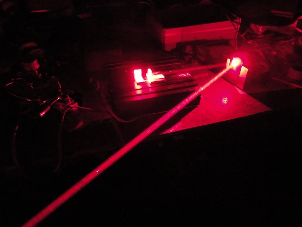

    Looks like about 5x6mm at the aperture. I haven't measured the divergence yet. The aixiz lenses aren't probably what I'm going with, just had them on hand.. eagerly awaiting Dave's 2mm in the GB ..

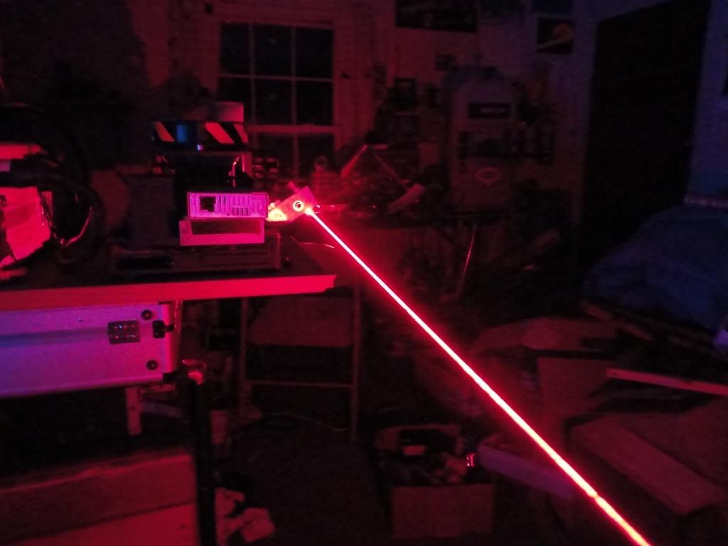

    The bottom pic is with no fog/smoke added to the air, just good ole clean appalacian mountain air. It's putting out some power, I'm sure a lot of losses though with the aiziz clipping the beam and the dust that seems to be magnetically attracted to the optics.. maybe the mountain air isn't so clean.. ? No pollution tho .. maybe dinosour dust ? :]

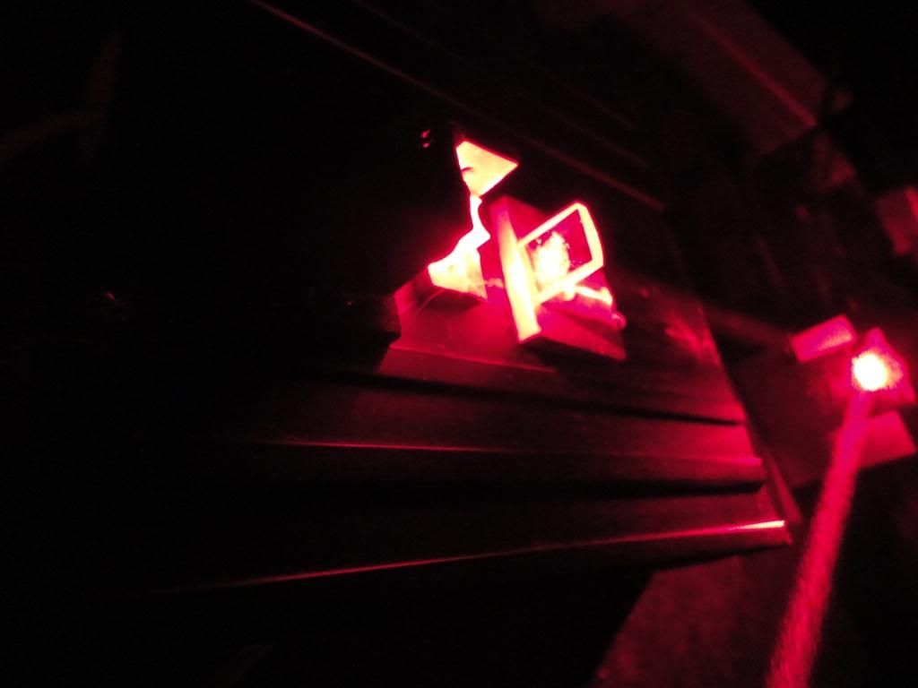

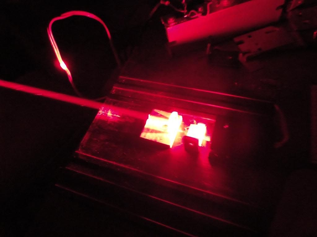

    Default We luvs us some pictures !!!!!! :)
    And now, for some more gratuitious beam shotz, this time with some smoke in the air..

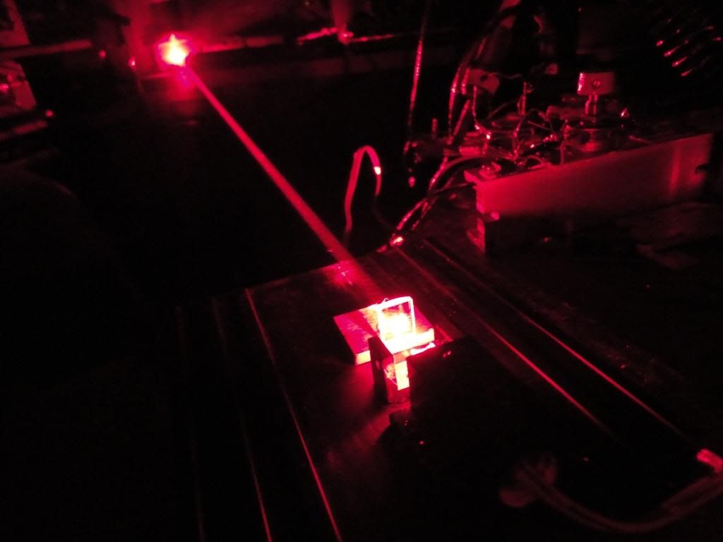

    Well, I tried it with a different lens this time.
    Experiment #2. Removed Aixiz collimation lens, installed Thorlabs 350340-A lens. A significantly smaller aperture beam size (3x4mm) was obtained along with increased power output.
    Experiment #3. The cyl-lenses were moved close to the emitter of the LD (~2mm), result: the far-field (100 ft) 'spot' size was larger than the dpss reference spot. (see image # 1) When the cyl-lenses were moved to 70mm from the LD, the spot size was improved (smaller ) see image #2. Sorry for the extreme blurryness of the pics but I had to use a lot of zoom to get 100ft photos and I couldn't hold the camera still enough (prolly too much coffee lol) but still can see a small improvement in far-field spot size despite fuzzy photos. There was no noticeable change in the near-field 3mm x 4mm (aperture) spot-size. Hope this info is helpful.
