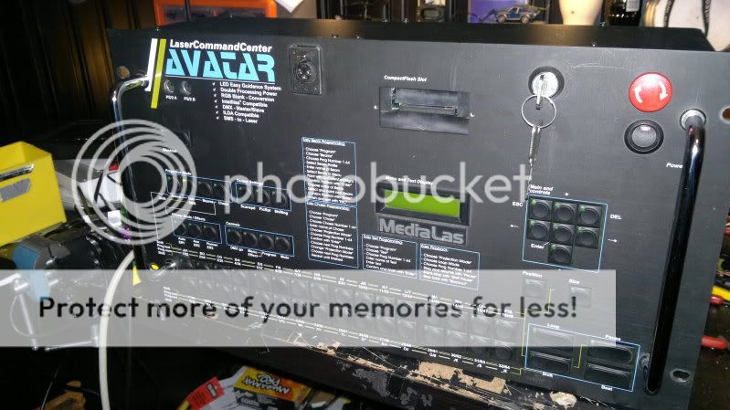

    I got this from a friend today
    Have been standing for some years not been used.
    It have a 250mb flash card inside.
    I tested it with my RGB laser and it works perfect
    I got it cheap and as payment for a job I`v done, but the owner told me it was unstable at times.
    So I opened it up and did find some bad soldering inside, I have re soldered what I could see with my eyes.
    And so far it works out fine, but it is old stuff.
    Anyway allot of fun with all the buttons.
    And it does play animations and beams.
    But does anyone here know what other fun stuff it could do?
    it says SMS-2-LASER , and it have a Serial COM\GSM port on the back.
    Can I find an old phone and use it ? (how does that part works out)
    Really not so sure what to do with it... I can use it, sell it or maybe some one want to trade?
    if you have some history about this, plz share
    //Filip

    hmm interesting, maybe I can use it for beams into mirror effects with one of my lasers.
    But that is a big box for so small amount of fun
