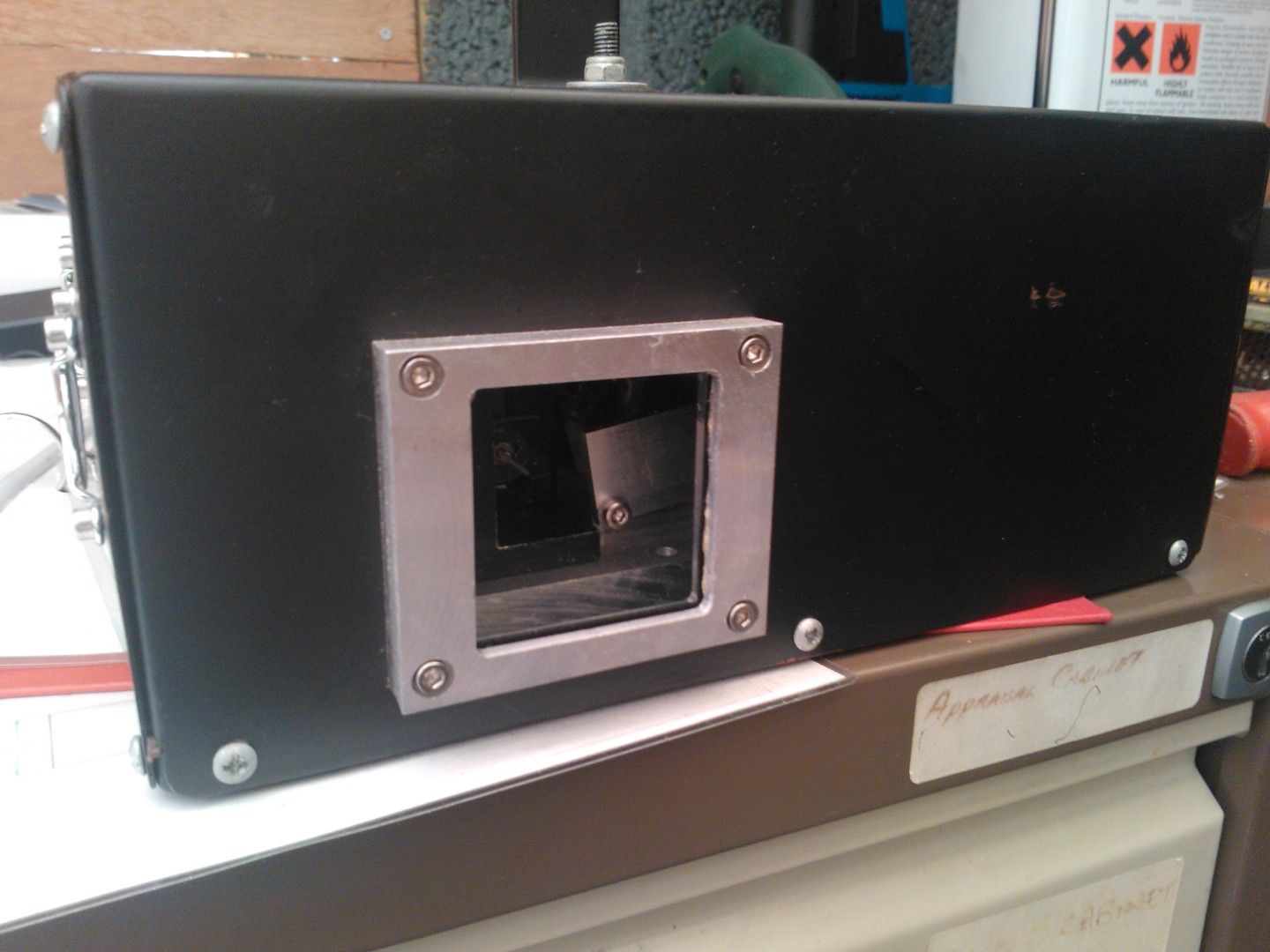

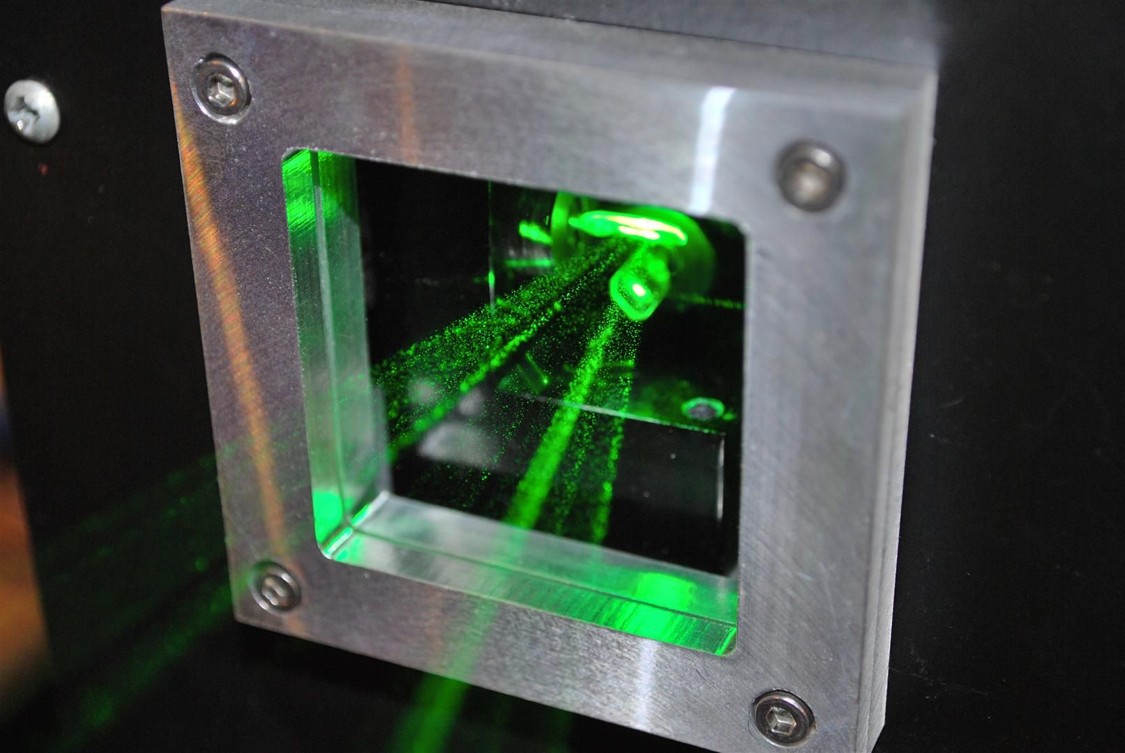

    While you're here, what sort of glue should I use to glue the window in place?
    Have you tried gaffer tape all around the window? Mines are all fixed with well placed and cut gaffer tape, and they haven't moved a mm since years! Easiest solution, and doesn't take more place than the window itself... Of course, doesn't outgas, and removing is easy

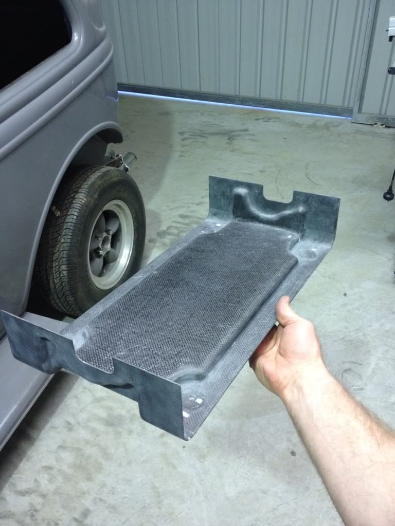

    Very nice build, loving the carbon fibre idea... F1 technology at its best

    Quote Originally Posted by kitatit View Post
    ..but it's like there is no window from what I hear.
    Yep, indeed, the stuff is so 'clear', it's really-easy to 'forget it's there', and mong it-up with them french-fried fingerprints! But, for when ya do, Tip: Much better than 'acetone', for cleaning the CDAR, is just some clean agua and a bit of mild liquid dish-soap, then water, again... Use a lintless-cloth or the 'kraft-type' paper-towel, for a track-free finish.. But, the stuff is super-tough, even if you have to 'buff' with the toweling, it won't scratch, unless you use something abrasive on it .. ie: no 'AJAX'..
    ..too, in your mount, see if you can put a slight 'tapered-shim' in the bottom, so you end-up with a very-slight 1-2˚ 'rake', shooting what little back-reflection there-is, UP, vs back, into your galvos.. ie: |\ ...Not for any-reasons of 'concern for the diodes', etc, just ensures you eliminate any of that annoying 'galvo-spindle glare' or 'ghost-reflections' off the Y.. Well-worth the little bit of extra-effort / metal, imho, to yield the cleanest-images possible...

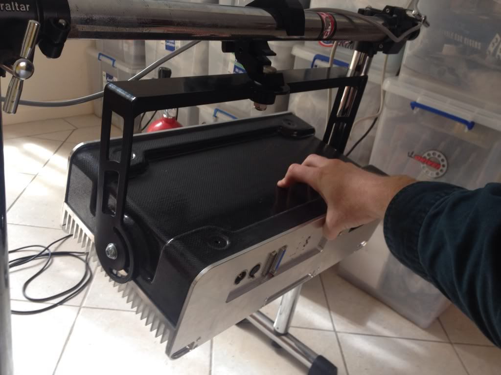

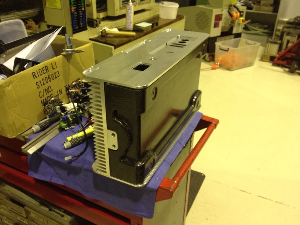

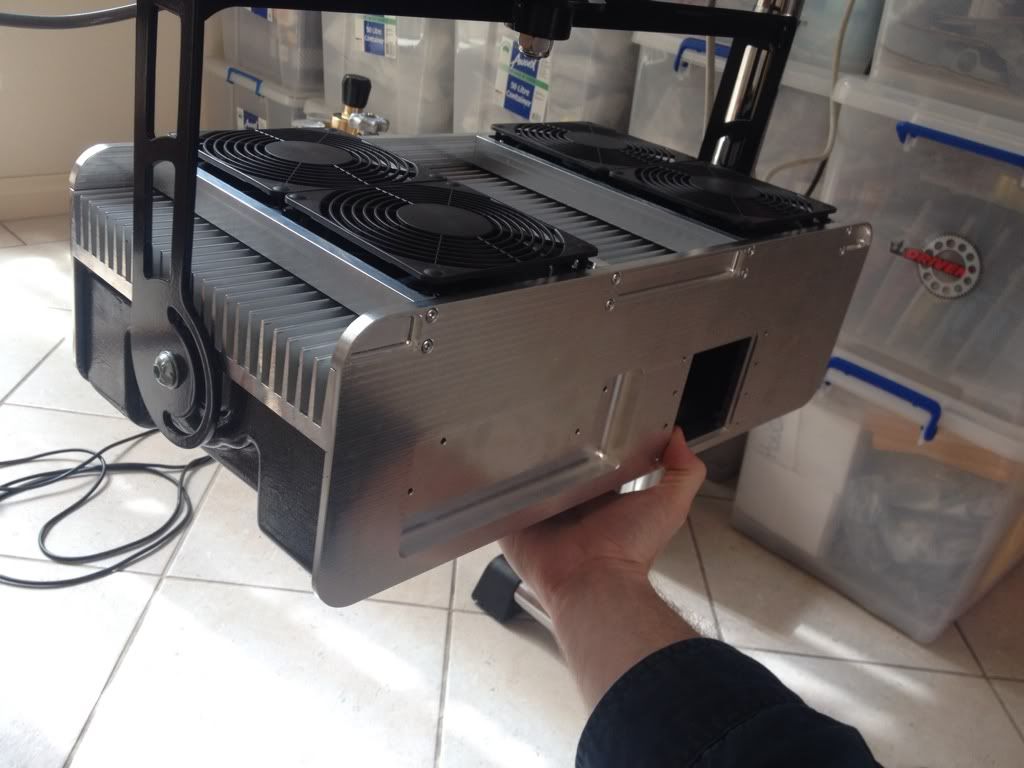

    Thanks Mark, hopefully it works out ok. If it does, it should allow easy access buy removing 3 sides with four screws and because of the rounded transition from the side walls to the bottom surface it should make for a good dust seal with the neoprene strip running around the edge.

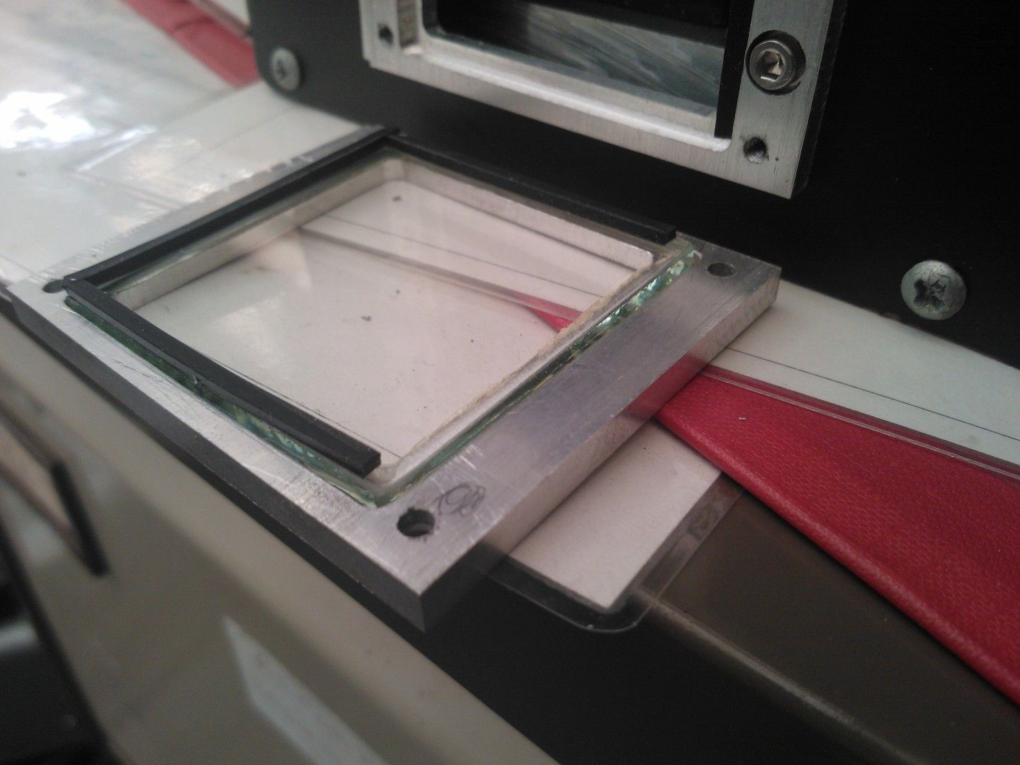

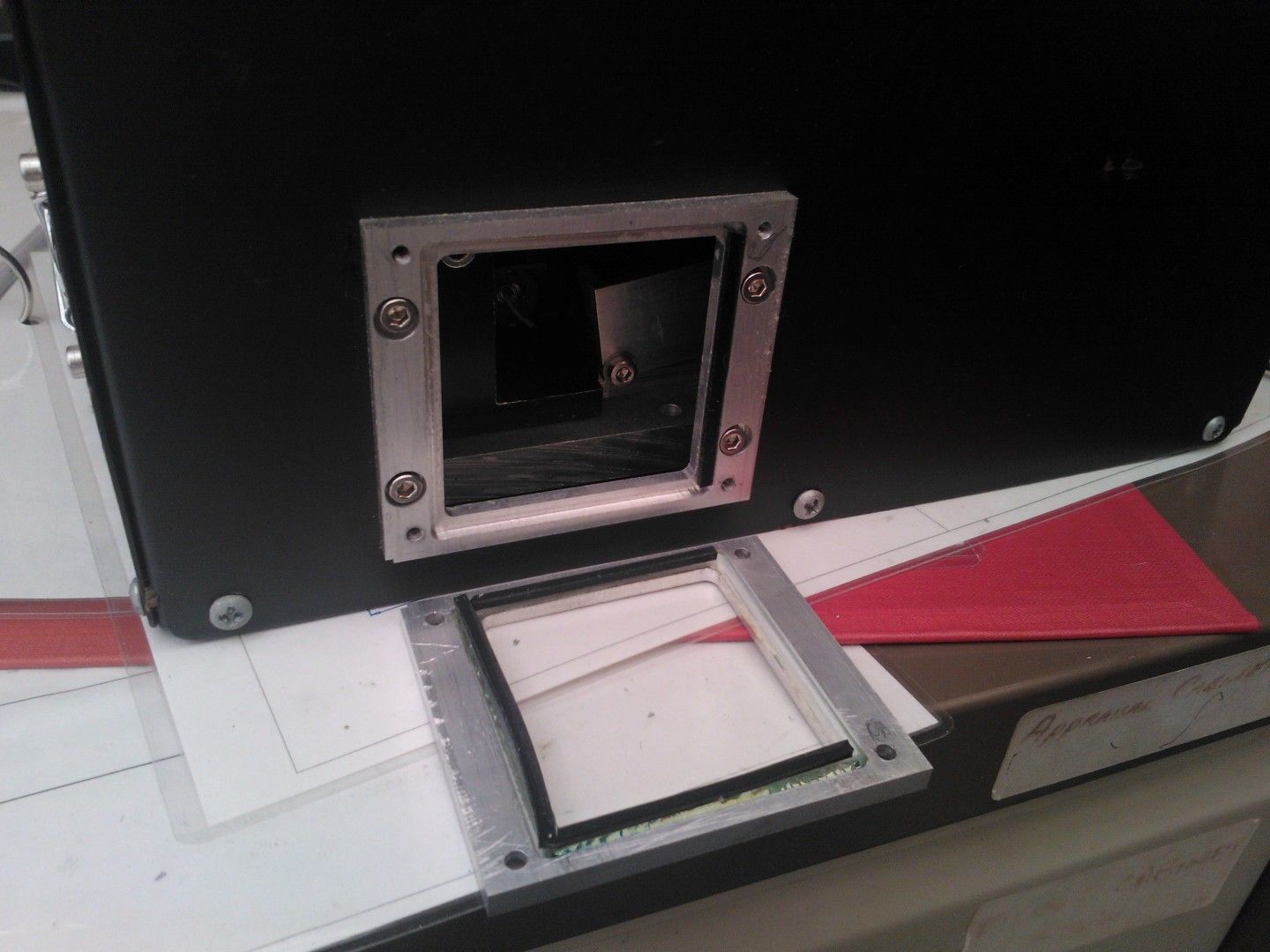

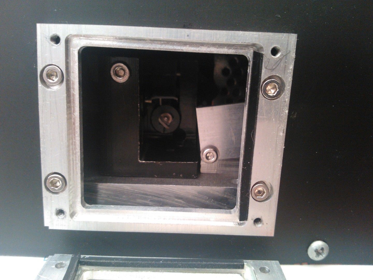

    been in there a bit to long and the rubber has stuck to the glass

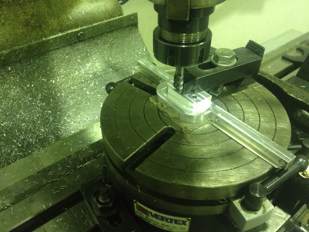

    Nice job mate. You are getting your monies worth out of your mill!

    think so, it gets used at least 5 days out the week

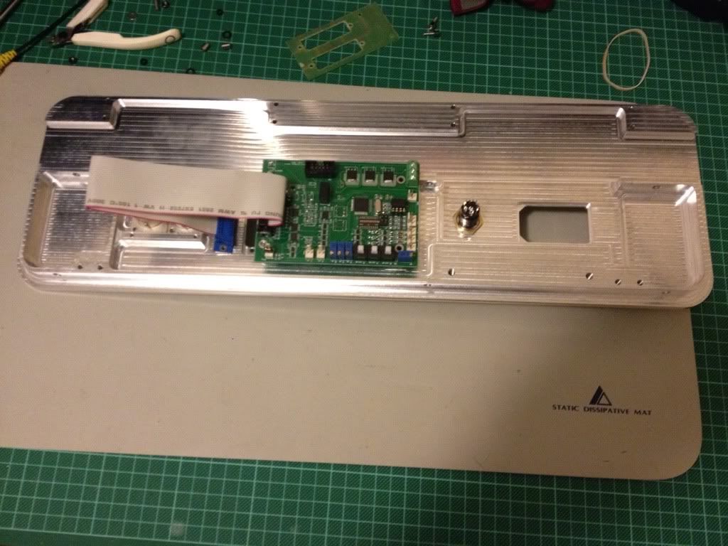

    here are some updated pics of my progress.
    I had it scanning a few weeks ago but as i still hadn't made the front and back panel and several other parts so I pulled it apart to concentrate on machining bits. Here is a short vid, sorry youtube mangled it pretty badly.

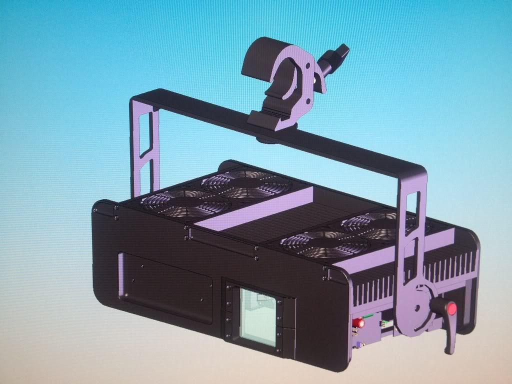

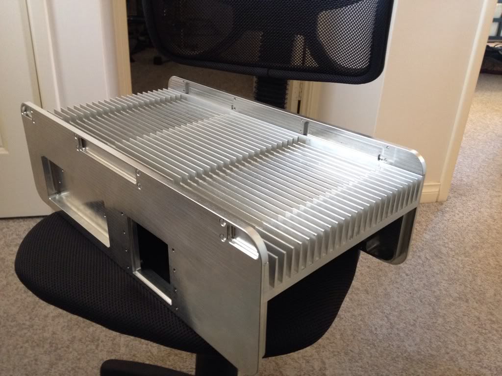

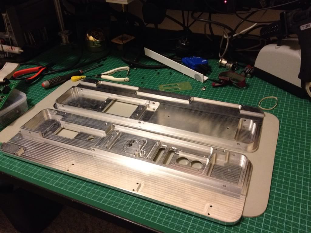

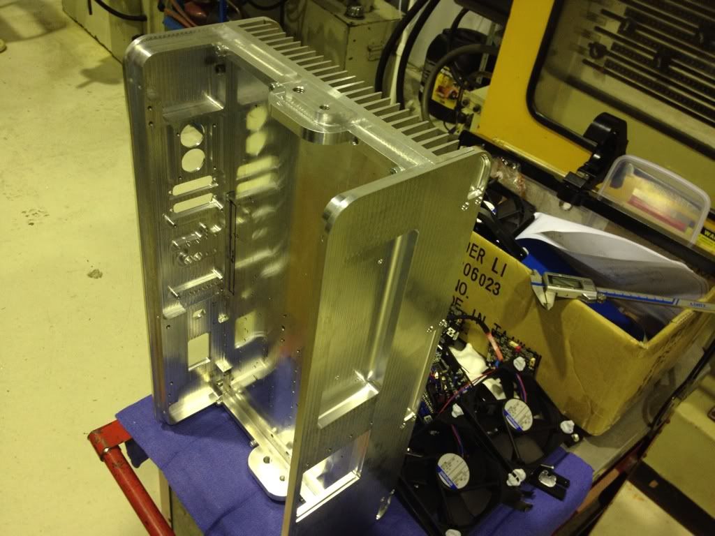

    I got the front and back panel CNC machined. Im very happy with how it turned out.
    It was my first time sending out CAD models to a machine shop. It turned out just like the picture! makes me excited to what else I can build.
    got a few smaller parts to machine still before I anodise it. Then i can wire it up properly.

    Thanks for the tips on the window guys. I heeded your advice and designed a screw on window. I've made it so you can remove some of the screws and mount masks or divergent optics if needed. cheers for the clues.
