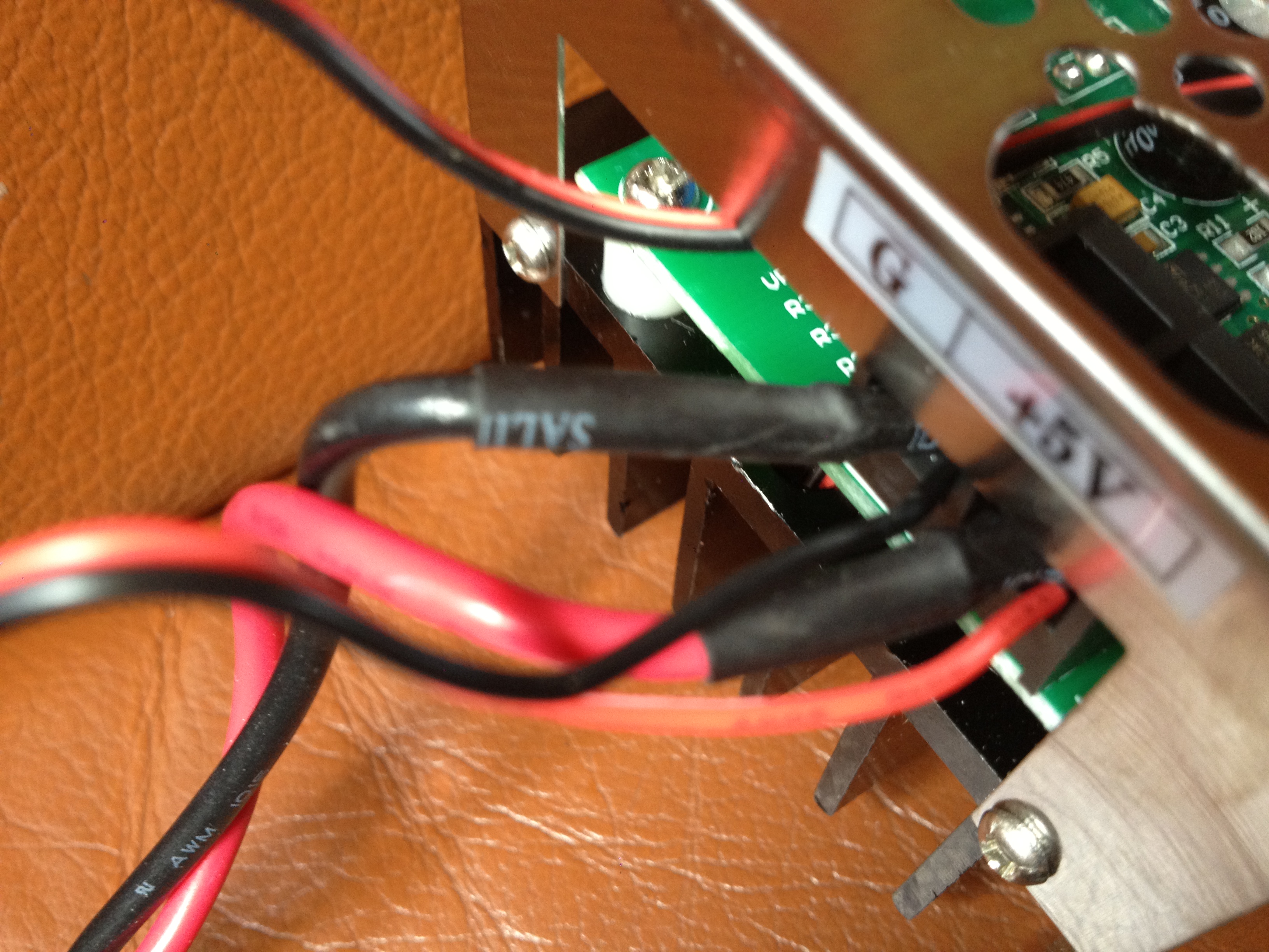

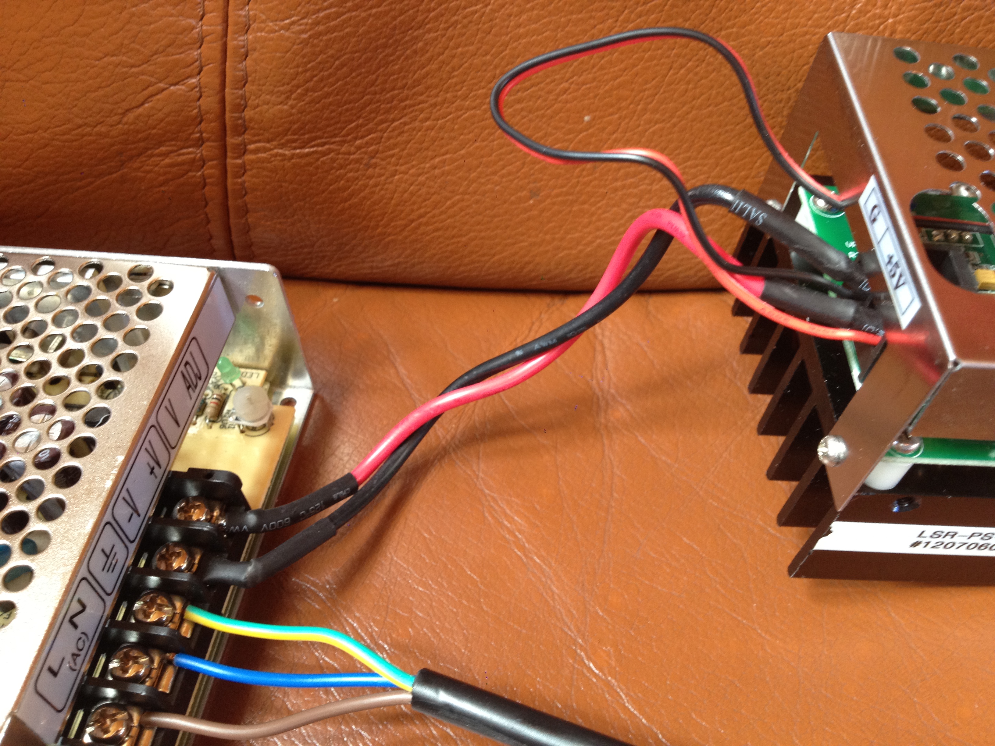

    Can you post pictures of your exact test setup, and include details of the methods/stages you are going through, right from the point of setting the voltage on the PSU?
    Are you using your own PSU, or one they supplied? It is DC, right?

    ah yes the pictures
    www.gdteam.net/IMG_5586.JPG
    www.gdteam.net/IMG_5587.JPG
    www.gdteam.net/IMG_5591.JPG
    okay il try to give some more details.
    During the story i now tell, i never connected the wires wrongly. i triple checked that every time again and during failure again.(well maybe wrongly, but then its wrong because lasever told me wrong)
    Simple how i setup the wires. The big driver got a red and black wire, wich are the modulation wires....those are connected back to the power imput of the driver so the modulation receives 5-6v at all the tests. lasever said 5-6v is fine for modulation and has no damaging results. The modulation reads 5v desame as 6v. The first psu i had was from lasever themselfs, for a other 532nm unit i got. but also puts out DC ofcource. tested with my DMM.

    Having gone back and looked at the pictures of your setup I would say your 5V PSU supplying the driver may not be up to the task. What is the rated output of the PSU and what is required by the driver? I’m just guessing at your requirements which may be around at least 10A. Pushing the 5V PSU to 6V will also probably decrease current output by about 20% further worsening your dilemma.
    PS. It would be amazing if Lasever were capable of sending a driver pre tuned to just be able to interchange like that. Driver and head are tuned as a unit and are in general not interchangeable like that. That’s like playing in the lottery, chances are slim to none.
    Nov 2010
    The Netherlands
    1,066
    It can supply 5v 16a, no idea how much the laser uses.
