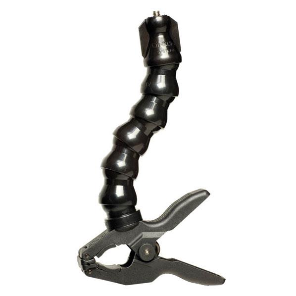

    Quote Originally Posted by Bradfo69 View Post
    ...these lenses need the ability to have movement vertically, horizontally and tilt. The gimbal mount affords the tilt forward and back, but not the up/down and side to side....
    Ah, glad you caught-that.. totally spaced out on detailing that part of the 'L-bracket mod' -(..then again, I posted that at what, 3am?? The 'lower-hole', that would go into the 'carrier', which goes on the dove rail (..which, btw, achieves all the Horiz. adjustability you'd ever practically-need..) should be a *SLOT*, not just a hole.. the 'top' hole, where the gimbal-base mounts, is-just a 'pass-thru' for the 1/4-20.. but, with the bottom - make it a 'slot' (hole nearer the inside corner and bandsaw / dremel, etc) and bingo, there's nearly an inch of 'Vertical-translation'.. And, you can make that 'L' as big as you'd want, for 'more V-travel', but.. I can't see ever-needing more than what a 1" L could provide.. Obviously, a 'prototype' is in-order, but.. I sure ain't got the time right now..
    ..And, yes, you could-get almost the same-result with the cheaper Dinkum 'fixed-base' - drill two holes, one above / below the existing and 'slot' with a dremel-wheel = V-translation.. Sure, that 'cheapo-method' would be a bit wonky in the H-axis, but.. you'd 'angle' that bracket, L/R, then 'back-adjust' the gimbal, to-compensate for the off-angle of the bracket..
    ..Sure, not as 'elegant' as the dove-rail set-up, but.. 'cheap', for those that would need it to-be... Personally, I'd go for the dove-rail setup, and the 'dual-clip' filter-holder... If-only that 'pellicle-yoke' was avail. for a 60mm lens..
    The biggest issue I see and, it's been mentioned before is the idea of "universal" that can go on any projector...
    Sure.. I started thinking this up, when I was replacing a clamp-set that, whomever stole / lost that $2500.-worth of gear last Dec on us prolly *has* in their shop came-across this - http://www.samys.com/imagesproc/L2lt...==_H_SW700.jpg - ..and I thought, 'well, shoot - one of these, plus a threaded-ring holder, (like the one Thorlabs one..) could-be pretty doggone 'universal'.. and, those things are *tough* - once you position them, they *don't* move, until you move them.. and the clamp - wow, the thing could tear one of your nipples clean-off..
    Anyhoo, again, not 'knocking' the designs / ideas in the thread, just saying, it is possible to 'diy', with relatively 'repeatable' / available stuff... What would be 'ultimate', imho, would be something like that 'pellicle-yoke', with quick-change clips, for the lens, and a super-mini, yet beefy, dual-gimble 'articulating-arm-style' adjuster, with locking-screw 'elbows', and a simple-base, similar the dove-rail... Then, you've got XYZ, all-covered, plus 'yaw / pitch / roll'..
