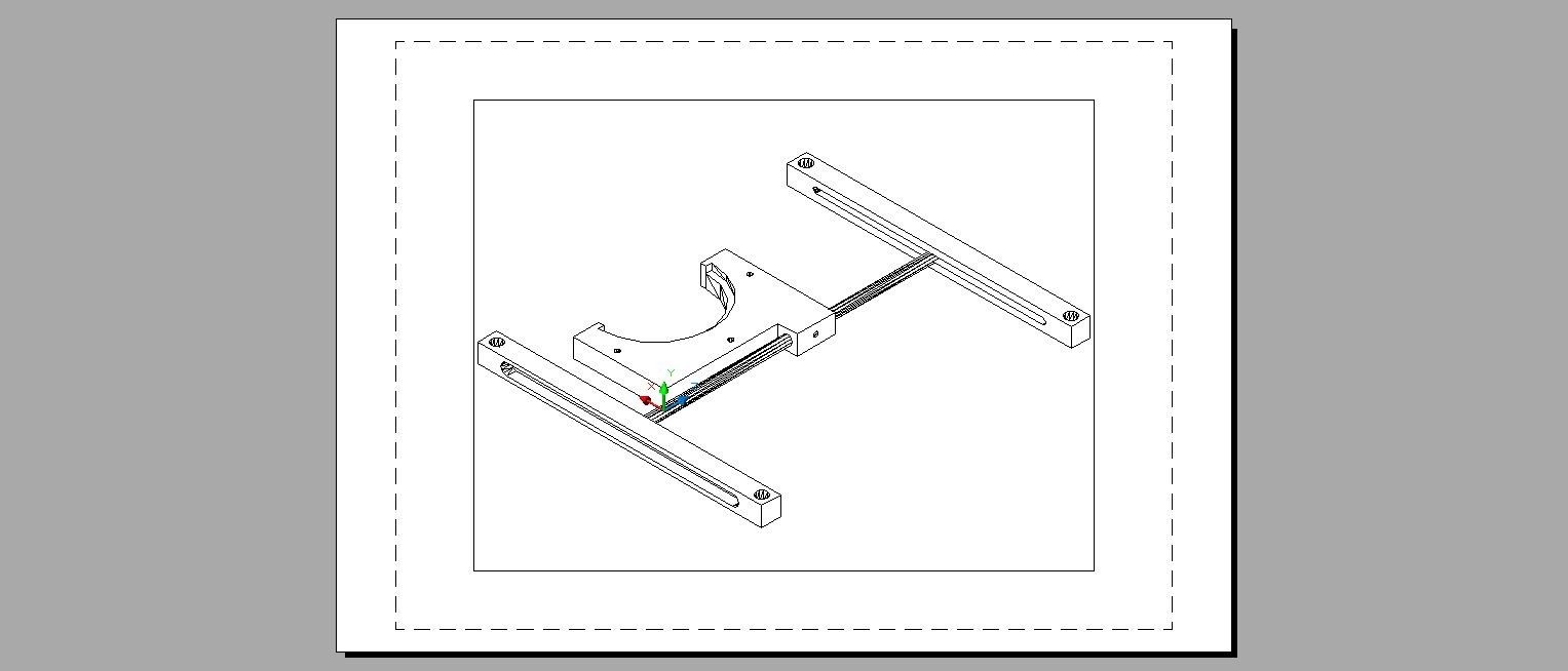

  1. #71
    East Sussex, England
    5,248
    BTW, when I said threaded bar, I meant plain round bar, with an internal thread.
    You then have a thumb screw/Allen bolt on each end which you pinch up on the outside of the vertical slot to hold it in position.
    I'm not sure what is a pain to adjust there.

  2. #72
    The Thorlab screws I posted a link to above appear to consist of a threaded spindle and a fixed sleeve Norty.
    I was thinking if some way could be found to connect the screw spindle to the lens holder on one side and have a either a 2nd screw on the other side, or a simple hinge spindle, and a way found to retain the the fixed sleeve in a block within the vertical rail, then you'd have a precision adjustment system much like on a Thor lab mount.

  4. #74
    5,248
    I've woken up with a vision of a hybrid design in my head. Something is nagging me about the 2 side bars, in as much as I think it's over engineered, and requires 4 mounting holes on the projector, where 2 should be adequate.
    I might fire up Google Sketchup and try and put something together (haven't used it in years!) but I guess we could share a file format a few people have access to between us so the various designs could be tweaked and a bit 'open source'

  6. #76
    I think the tilt is necessary with the 1/2 lens to prevent ghosting from memory. You can see this in the video at LSDI even with the projector mounted flat on a table. Not doubting what you're saying Maurice but there's obviously a difference between the lens. Maybe its the fact they're 1/2 lens as I seem to also remember some mention of internal reflection from the boundary.
    From this pov I'd definitely like to see a precision adjustment made possible rather than just a tilt and tighten philosophy.
  7. #77
    Under a rock in Cambridge UK
    1,353
    Ok, this is by no means accurate, to scale or a proper engineering document... Just made in 5 minutes with PowerPoint, but you get the idea...
    The bottom part screws to the projector via the slot with two screws, the two uprights screw to the bottom part with 4 screws, allowing you to make sure they are vertical... This assembly gives your up/down and lateral movement... The lens holder is mounted into your uprights via two round rods fixed with grub or thumbscrews and this gives your tilting movement...
    Like I say, not a set in stone design, but a good start point... It's fairly elegant, not too complex and provides all axis of movement with easy adjustment...

  8. #78
    so something like this
    Andy, I think Maurice and Marc have the tilt design spot on hinging it at the top rather than the bottom.
    Thinking about it carefully, although a top hinge does mean the bracket needs to stand out further from the projector, there are 2 fundamental problems with a bottom hinge as in your original drawing:
    1. Safety - if the tilt screw should slip or work loose eg as a result of bass vibration, then with a bottom mounted hinge, the lens will swing downwards under gravity 180 degrees and finish up upside down and no longer over the aperture thereby exposing the audience to the un-diverged beams. With a top hinge arrangement, if the tilt screw should slip, the lens will just hang there vertically from the top hinge plate and will still cover the aperture.
    2. Horizon - With a bottom hinge arrangement, as you tilt the lens forwards you also bring the top edge of the lens and thus horizon downwards also. Although the distance may be minimal - perhaps only a few millimetres or centimetre at most at the projector end, it will throw the horizon lower in the room. This means re-adjustment of the vertical position following the tilt adjustment. If vertical adjustment affects the angle of tilt adjustment required due to the curvature of the lens and thus changing angle of incidence, then you could enter a cycle of constant adjustments between tilt and vertical plane. By contrast hinging the lens at the top, ensures the horizon is always maintained once the vertical adjustment has been set as its the bottom of the lens that moves up slightly, not the top that moves down.
    One further thought, although not to actual adjustment design, I think consideration needs to be given to lining the lens holder with something soft eg a very soft plastic or some other suitable material because at 100 Euro / Pound / Dollar per lens, they're very expensive to scratch and although it could be argued scratches on the lens edges won't affect the performance, if you have a hard material forming the actual lens cup part, then its only a matter of time before you catch the surface of a lens on it when fitting or removing the lens resulting in a very expensive mistake. To my mind, its better to design a soft non scratch holding cup from the start.
    I quite like Marc's design as its simple although I wonder how easy it will be to adjust 3 planes at once. It could be easier with more parts and thus screws controlling each piece.

  9. #79
    5,248
    Actually, the design I'm fighting Sketchup with uses a bottom hinge AND is designed in such a way that it can't swing out of the way in the event something comes loose.
    I just need Sketchup to admit defeat, and let me do the things I want to do!
    Re: your point 2, the actual amount of tilt required to make the top edge parallel to the beam is inconsiderable in the situation you describe Al. We'll be talking centimetres difference, even at range, and you should have that sort of tolerance built in anyway to account for sway/vibration in the projector fixing system
