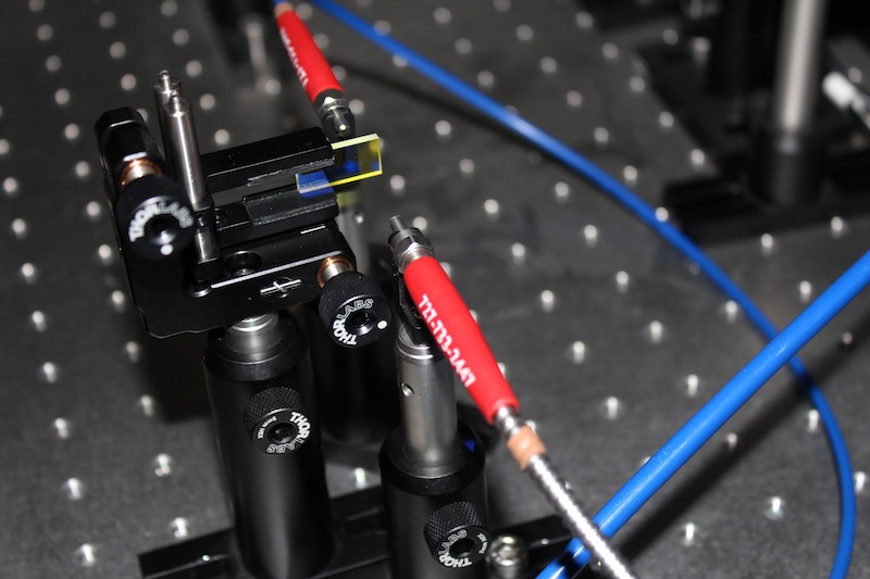

    I have spent some time this afternoon testing all of the dichroic mirrors on the spectrometer that Bridge has kindly sent.
    The Setup:
    A temperature stabilised Ocean Optics S2000 was used to make all measurements (at 21°C)
    The light source used was a Mikropack HL2000, and was allowed to stabilise for several hours before use.

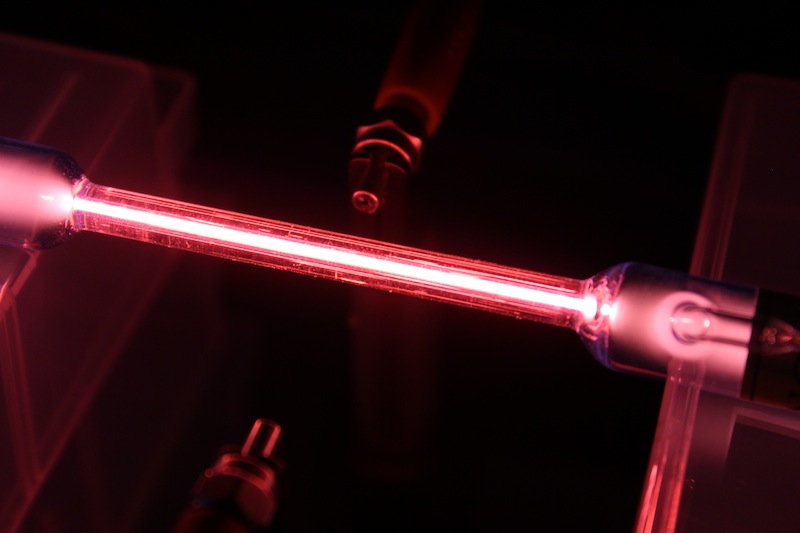

    The calibration was rechecked against an ampoule of neon; (excited with around 10kV, 5mA).
    Results confirmed the calibration was accurate. I'm unsure of the purity of the Neon I used, but it's clear there are some other elements in the discharge.
    (Red are known neon peaks, black is the received spectrum.)
    Bridge sent over 6 unlabelled dichroic mirrors, 3 of one kind, 3 of another; I will simply refer to these as "Type A" and "Type B".
    All were tested at varying angles of incidence [0°, 30°, 45°, 60°], with care taken to ensure test conditions were the same throughout.

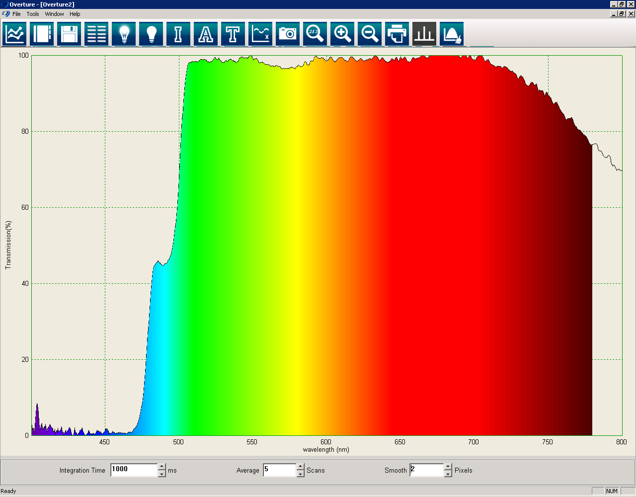

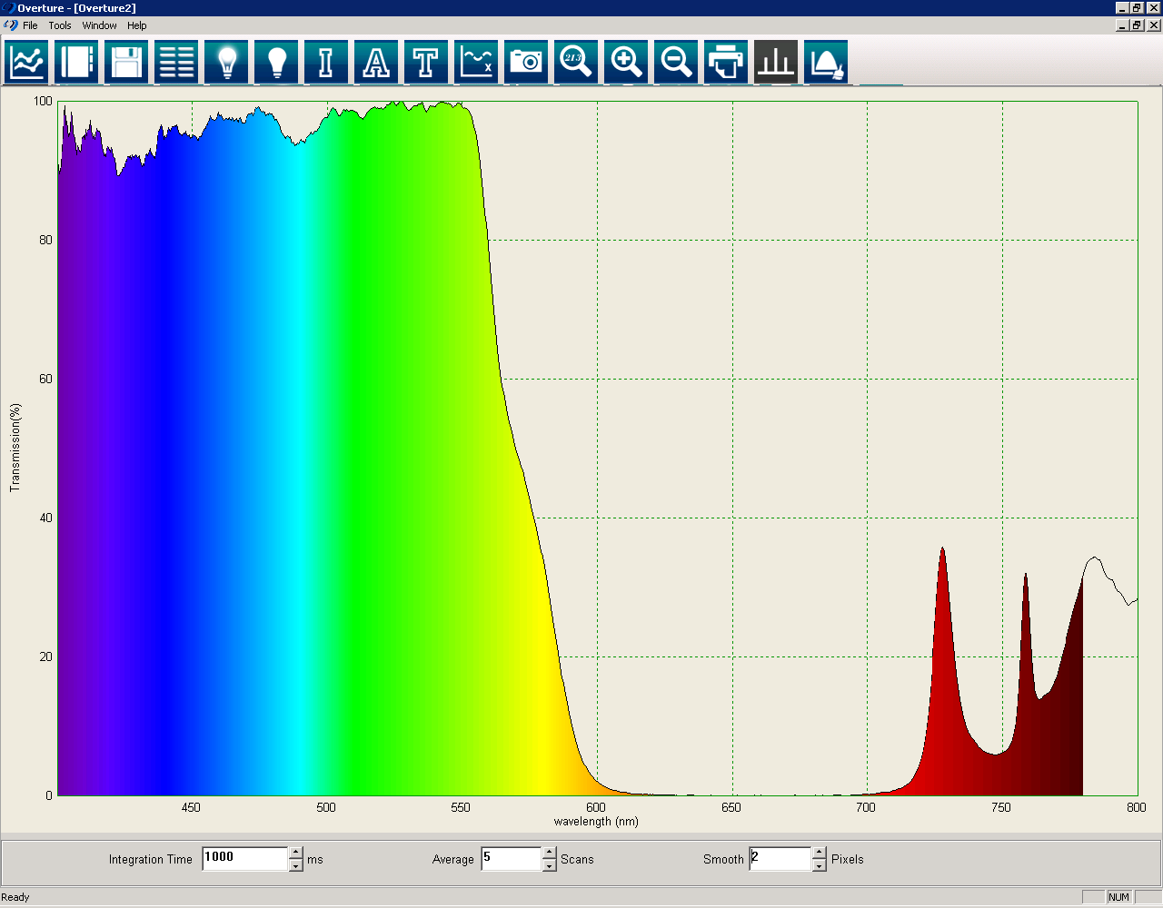

    Example "RAW" plots:
    Dichro Type A, No. 2, AOI = 45°, Transmission.
    Dichro Type B, No. 2, AOI = 45°, Transmission.

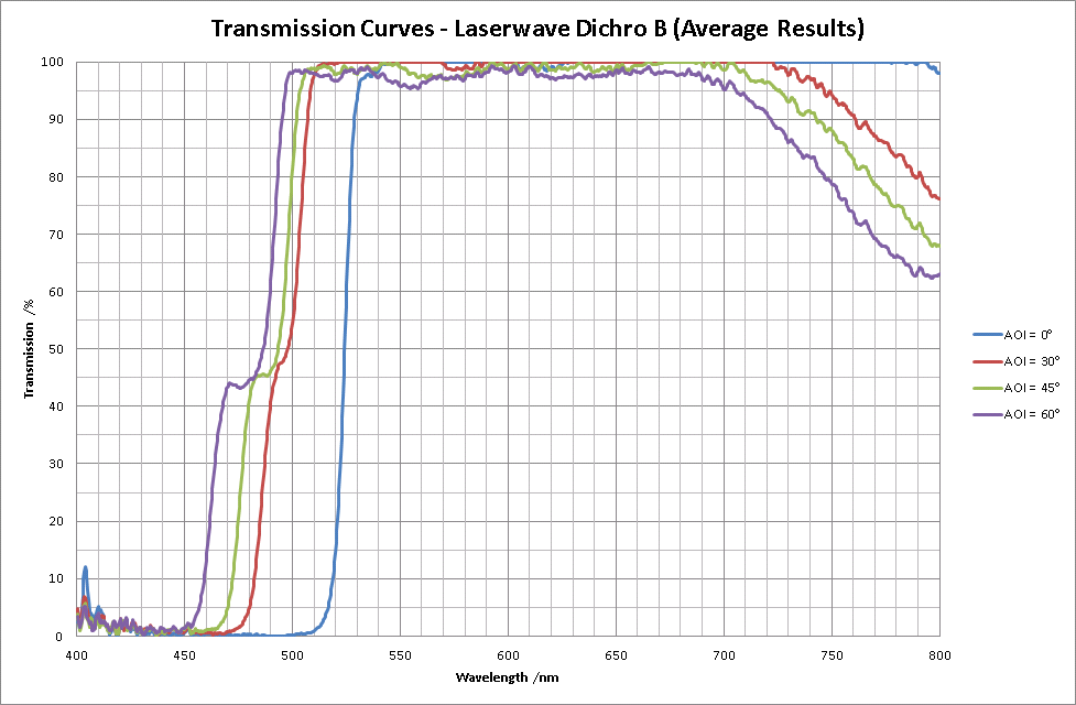

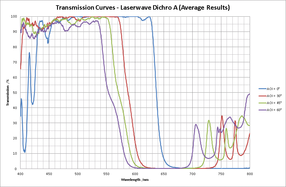

    The Results:
    The tested spectrum range was 400-800nm
    Test results were averaged for each tested mirror, and close concordance was found throughout.
    Average transmission plots were then created for each AOI, for each mirror.
    (For reflectance plots, simply assume an inversion).
    Final spectrum results:
    The created spreadsheet with all raw data, plots and individual transmission curves can be downloaded here:
    http://www.danielbriggs.co.uk/laser/...DichroTest.zip
    File naming convention:
    "Dichro_x_y_z_T.PNG"
    x=Dichro Type, A or B. A = Transmit Blue, Green, Reflect Red. B = Transmit Red, Green, Reflect Blue.
    y=Dichro ID under test aka "repeat".
    z=AOI [0°, 30°, 45°, 60°].
    T=Transmission test.
    Both appear to be very high quality and it is clear either dichroic mirror is suitable for the new 515-520nm DI greens at the standard 45° AOI.
