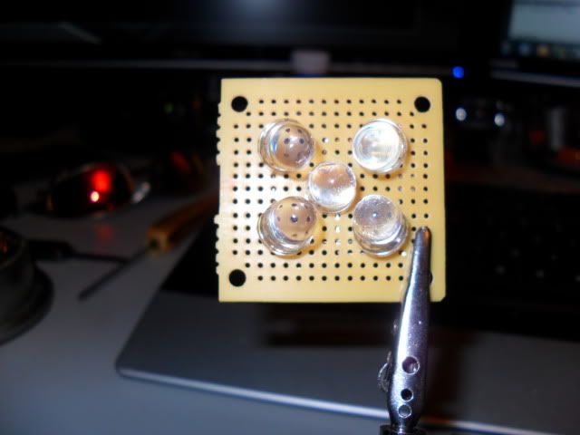

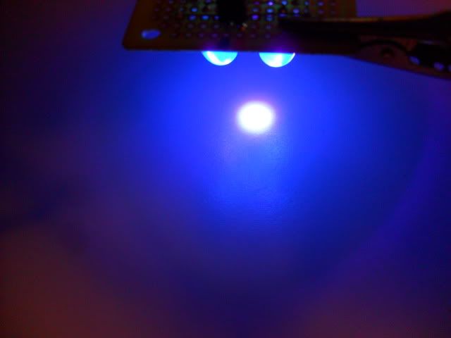

It consists of 5 10mm super bright UV LED's, a couple resistors, a prototyping PCB some wire and a 12V wall wort. All I did was arrange the LED's in a pattern, leaving a little extra lead on the outer LED's. Once lit, The outer four LEDs were bent and focused on the center spot.
Here is a pic showing the LED's un-focused...
Here is the output of all 5 LED's focused...
Here is a pic of the LED array...

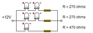

And here is how it's wired...
It takes about 30 seconds exposure of a small blob to get it tacky and about 5 minutes to full cure, It won't work for every application but I thought it was cool enough to post for people using UV cure glue. If you want to build one, here's the parts list.

1 - 470 Ohm 1/4W Resistor
2 - 270 Ohm 1/4W Resistor
Note: you can use a different wiring configuration or PS if you want to. This nifty little Wizard makes it easy.
1 - 12VDC @500mA Wall Wort
