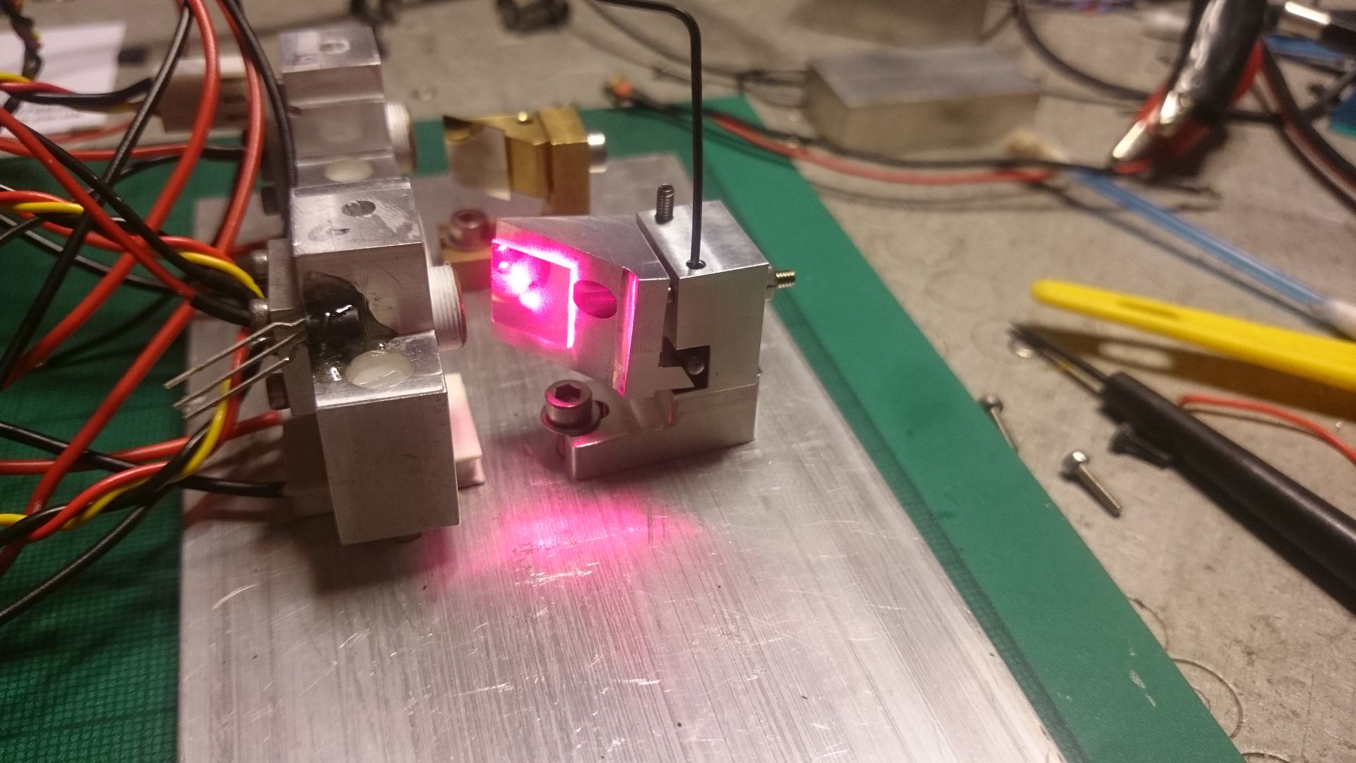

    is very pleased to say i think i have finished the top adjustable mirror mounts
    did a mod to version to and it pretty much solved the head twisting which is good.
    so now i need to make some more and send them out to a few people for stability testing

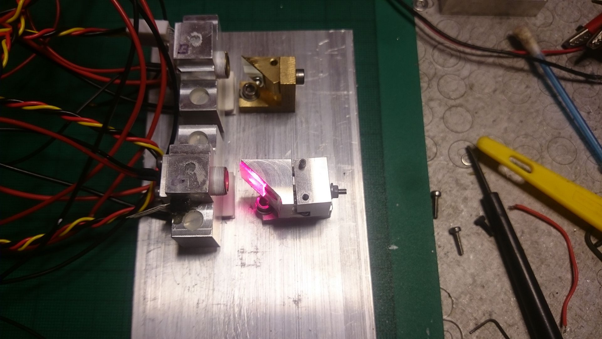

    after a number of tweaks ive finally got something im very pleased with.
    up/down and left/right movements are very good, the head is pretty solid. im going to be making a batch of these and looking for people to test stability
    the mount measures 14mm wide by 26mm deep by 28mm high
    those are cute and would look great in my next projector!

    next step is to code up and machine a batch, that's a pretty big job. then I need to get stability tested, next to some existing mirror mounts.
    also im sure the price wont be great.
    3 machined parts, complex parts (one including 3d milling)
    3x screws
    3x ball bearings
    2x grub screws
    1x high tensile spring
    1x nut
    = not cheap
