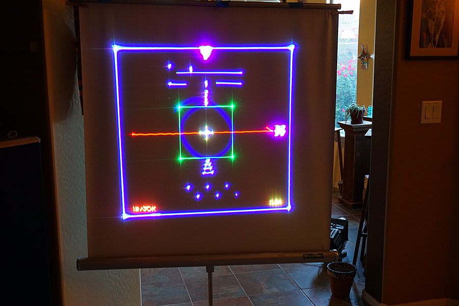

works for me, but i notice if you don't have the delay settings correct, the output looks like rubbish. clearly there are some scanning optimization settings to be tweaked, but it does work.
the oscillation in my test patterns is typical dt40w artifacts.
here are some quick crappy photos to demonstrate.
ack. looks like image upload is buggered again.
http://www.monkeyhands.com/images/photos/LFI-1.jpg
http://www.monkeyhands.com/images/photos/LFI-2.jpg
Bizarre. That looks normal and nothing like what I get. I would think my projector was hosed if it weren't for the fact that I can unplug the ED and plug in my Riya and then get a perfect test pattern. I'd post pictures but I can't find a way to get my camera to take a long enough exposure to capture an entire frame.
