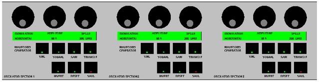

    A bit more thought on the subject. As stated earlier, I have always used live desks for shows. Mainly because I like the hands on approach to operating, I knew where every one of my stored 200+ "patterns" were locared and could find them in the dark without looking at the buttons.
    I also liked the ability to modify these at will, working live gives you the ability to react almost instantly to changes in the music, something not so easily done on a PC. Also, in Europe, beam shows are used much more frequently than graphic shows.
    I agree that a good "interface" is definitely required between operator and a PC if you chose to work this way. I know Pangalin do their Live keyboard but it is very expensive here. I am also unsure that it would give sufficient control over the abstract effects generator. What I believe is required to perform this task would be something like thiis idea below. This would give full control over 3 sets of oscilators. Simply choose an initial "Shape" and add effects as required.
    Here is a close up showing the details of each oscilator section in detail.
    Each section has 3 rotary encoders.
    1, Controls selection of modulation effect-
    e.g. Vertical Move, Horizontal Move, Spin, Rove, Pulse, Step Out, Step Rotate, Random
    2, Controls amplitude of effect
    3, Controls speed of effect
    A Backlit 2 line LCD display gives a readout of your selections. Usefull for making notes when good patterns appear, or trying to recreate one you accidently deleted. It is also essential to be able to see what you are selecting in the dark corner you are usually operating from.
    A lower set of buttons chooses a waveform which can be overlaid to these effects. This will provide an additional level of movement and are extremely effective.
    A further row of buttons gives basic command controls.
    Invert (inverts selected effect eg Spin C/W Spin C/C/W)
    Reset (sets all selections to 0)
    Save
    Three of these modules should fit nicely onto a standard 3U 19" panel and blend in nicely with Mr Pangolins live desk.
    Connection to a PC could be either RS232 or USB. This would make everything nice and dandy with no connectivity problems to almost any PC.
    This is the kind of interface that would tempt me to use a PC based system over a live desk. I also willingly offer my services as a Beta tester should this project move beyond my initial ramblings.
    If anyone needs additional info on these types of analogue control systems, please let me know. I can put them in touch with George McDuff at Chameleon Technology. He has almost 25 years experience in designing and building analogue laser desks. Fortunately for me, his workshop is only actoss the road form where I live.

    Same here, I'm a huge fan of being able to take over what is going on with abstracts with a bunch of knobs and buttons. I'm not completely familiar with Pangolin's Live! console except that I know its a serial interface. And I'm not so sure that you can adjust abstracts with the console at all. A seperate box aside from the Live! console would be very nice but I think it would require alot more knobs and buttons than you might think. Here is a screen shot of the Pangolin abstract generator. I'm thinking it would need about 2 dozen knobs, a whole mess of buttons and the ability to still choose frames as waveforms from the console.
