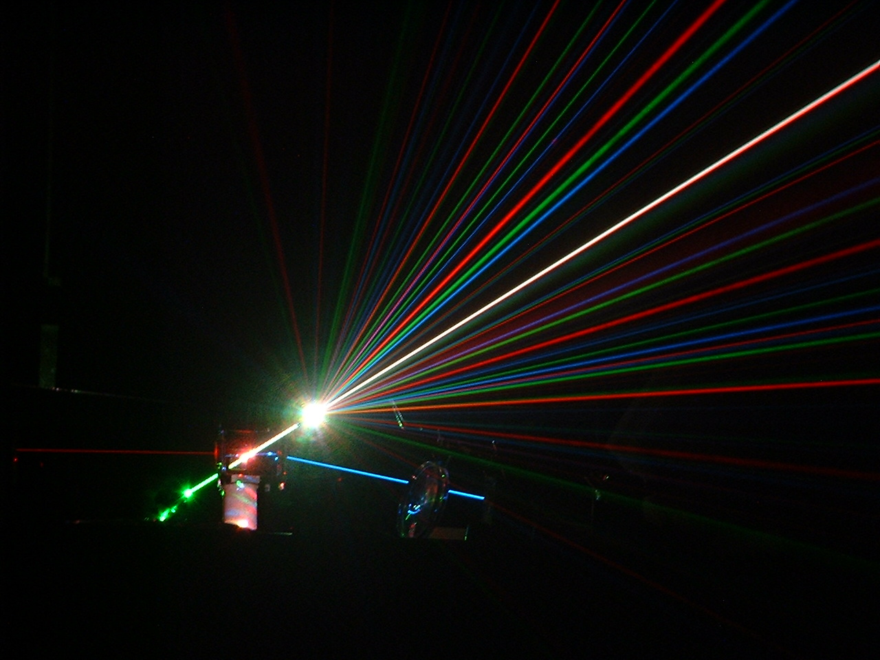

    As others have mentioned, a "burst" or "grid" diffraction grating will accomplish the effect you're describing.
    Here's what it will look like:
    For a quick test, you can try the cheap holographic film that they put into those "fireworks laser viewer" novelty glasses that you see for sale on E-bay. Good for a watt or two of power, at least for short exposures. (That's what was used for this picture, although the power level here is only ~ 30 mw.)
