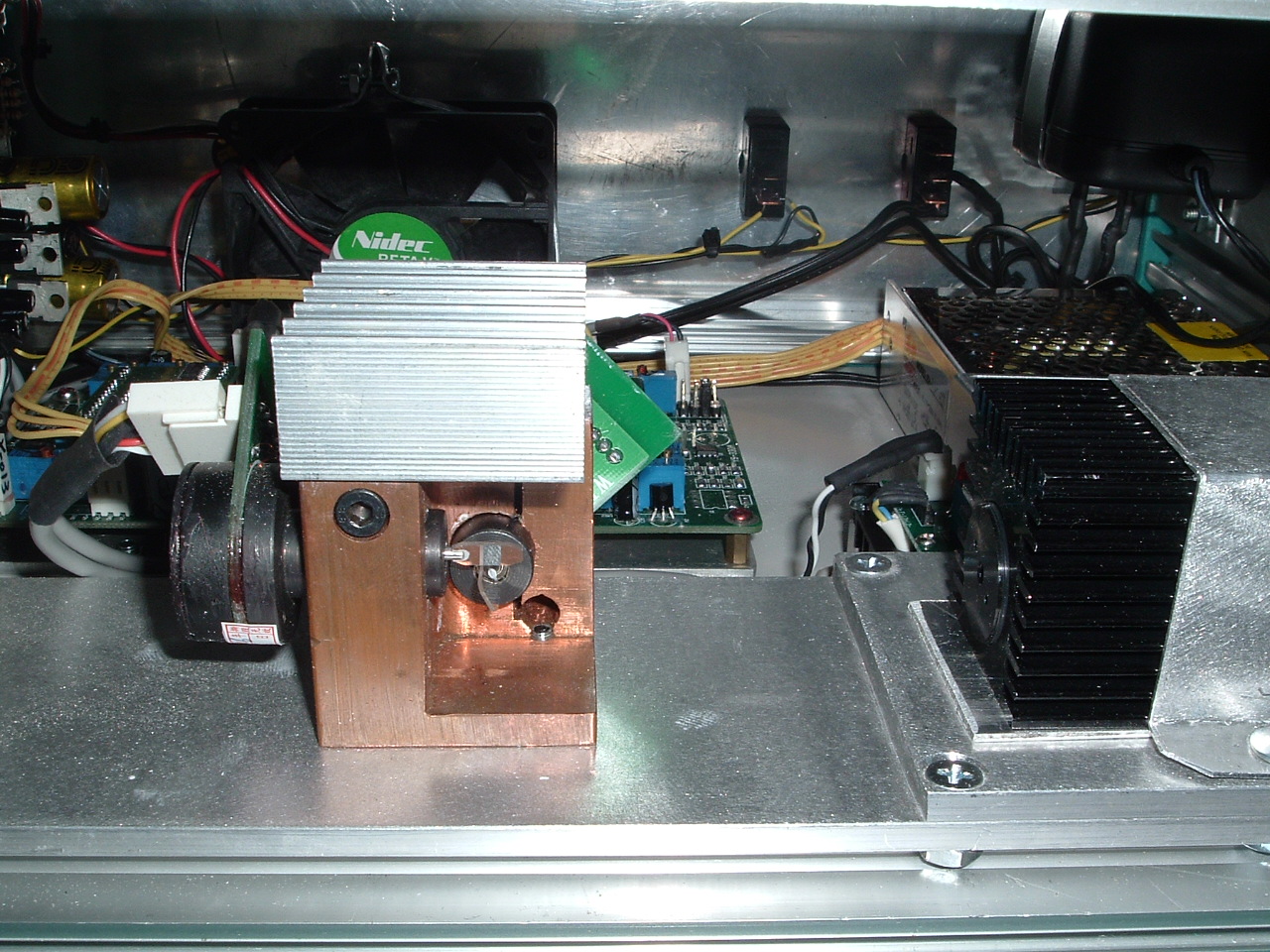

    Regarding your image on what the device might look like, it's probably going to be larger than you think. As for the "magic" portion, that will be the scanners, which will move the beam around to draw the pattern. Here is an example of what it might look like when assembled (this is a single-color laser projector).
    Making it battery-powered is possible, but it will add complexity and you may not be happy with the battery life.
    PS: Here's another image that shows you what it would look like with the laser operating...
