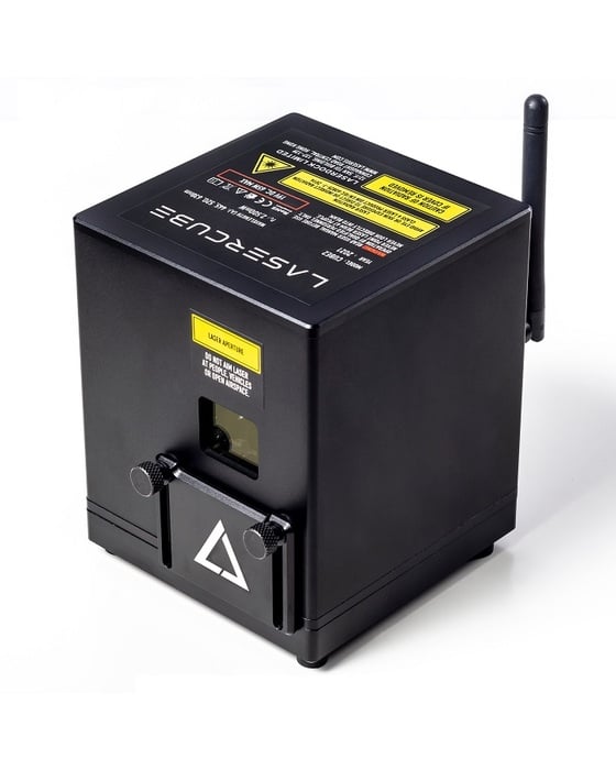

    So I got a Lasercube last week.
    Lumia is my favorite laser effect and the Cube has a few good Lumia glass filters, but there's no way to rotate the beam smoothly.
    At slow speeds, step-step-step.
    So i'm pretty sure I'm going to need to put some rotating glass up front. Ideally I could attach it to the cube somehow and run the motor off a USB battery I can tape to the cube.
    Any ideas? Sadly, I'm not an electronics wiz or basement craftsman. I'd need as close to plug and play as I can get.

    I dunno if anyone has tried it; the cube does have bolt holes on the front, so it should be possible. Might need an adapter plate; will need to know the exact dimensions of the front of the unit to properly position the aperture-to-aperture alignment.
    Or you can velcro the Wobb to the front of the cube.
    The unit runs from 12VDC, so it should be possible to rig up a battery.

    Appreciate that, just need to figure out how to fit it (velcro is a good idea, still need to figure out where) and the battery thing.
    And I have to make sure I can afford it! $600 was out of reach but 400 maybe...
