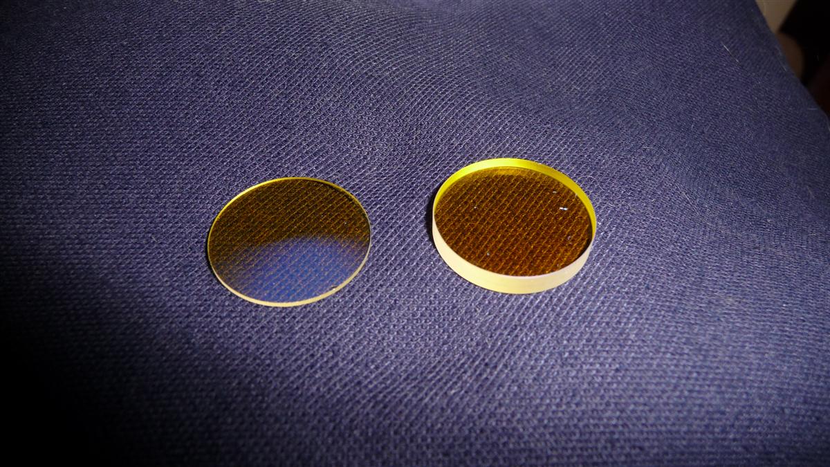

    My Edmund Dichro arrived today (less than 24 hours!)

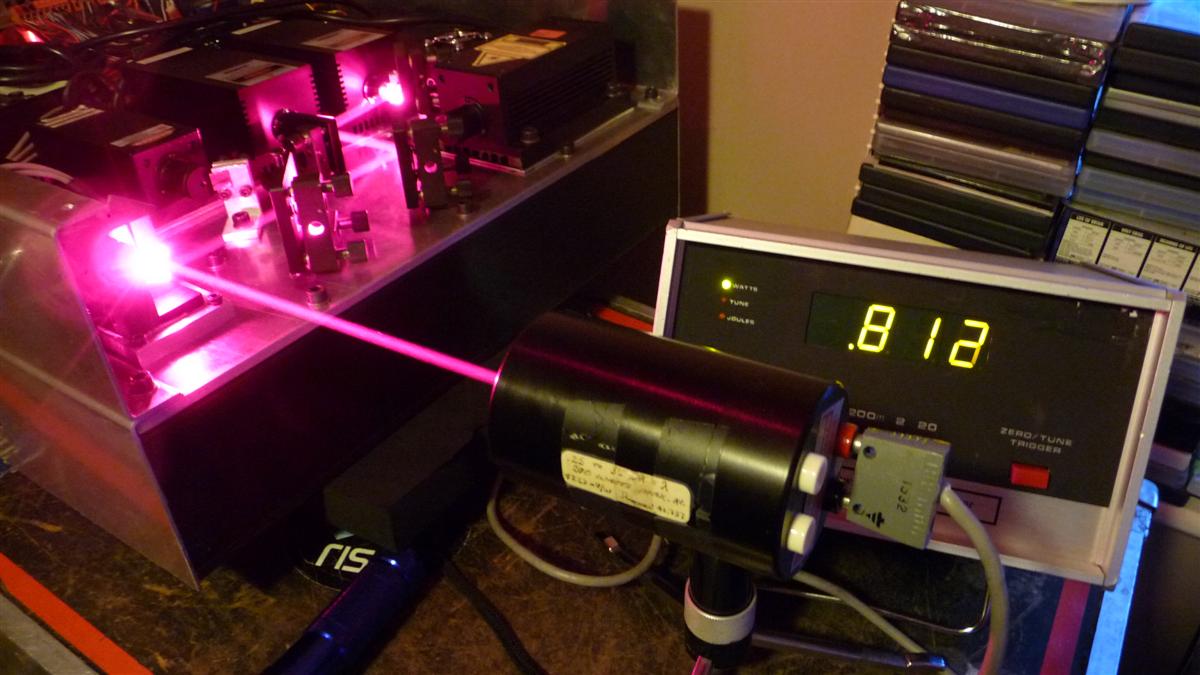

    Here's the before shot:
    Here's the new beasty sat next to the Laserwave item.
    Because the Edmund is so thick I had to realign the lasers due to beam offset effect.

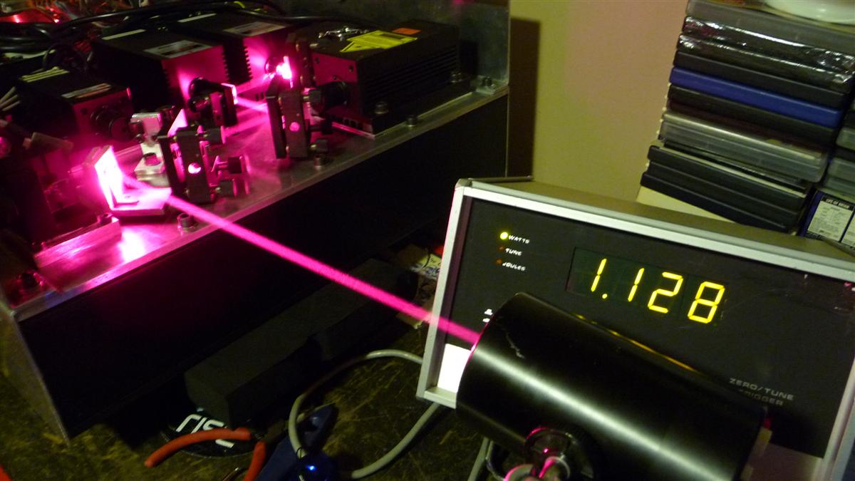

    ... and here's the after shot:

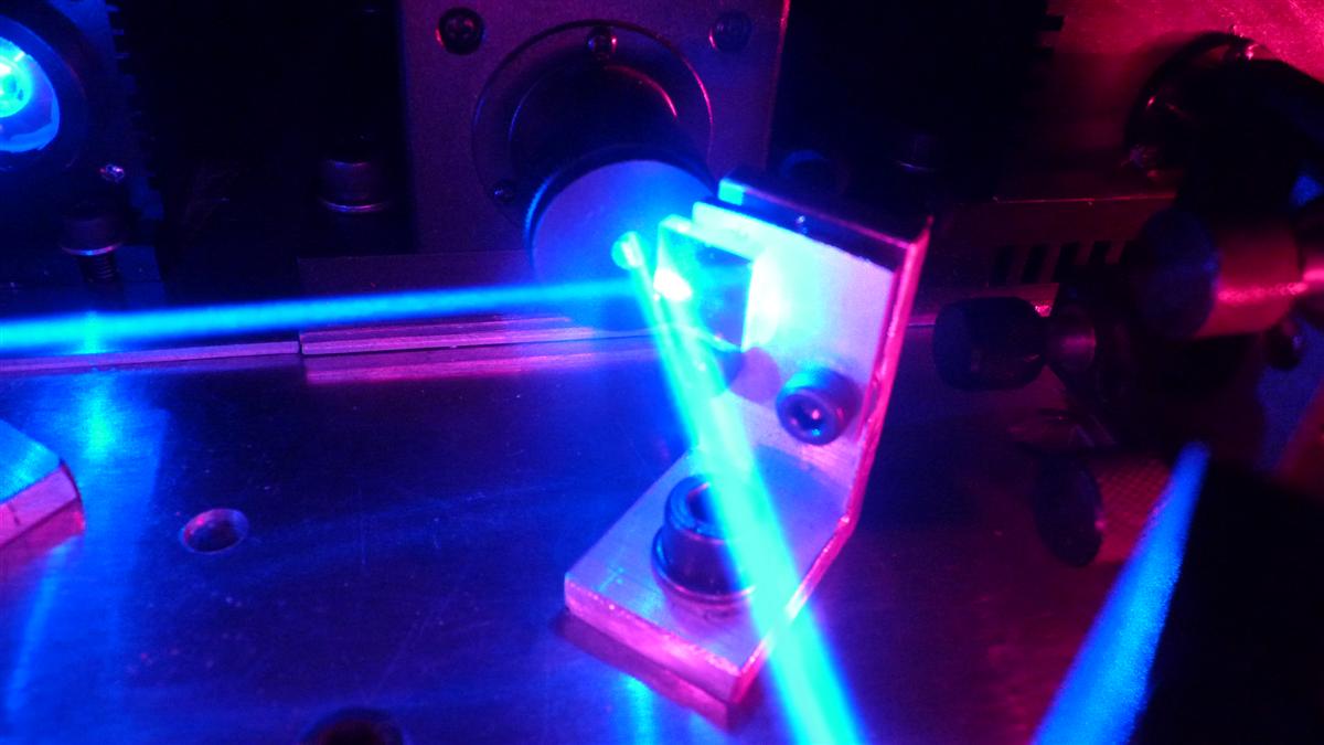

    FYI there was a 3mW loss of green through this Edmund!

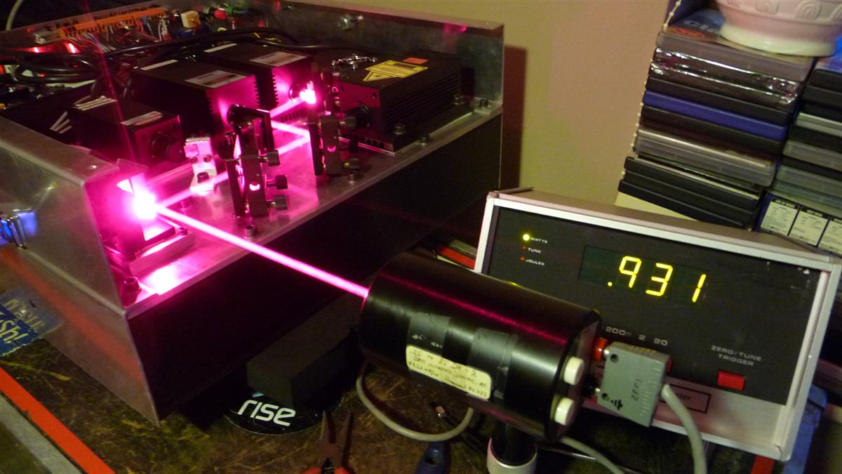

    Here's a shot with the galvos out of the loop
    Now if I could just get my other stolen half Watt back from that pesky PBS cube..........
