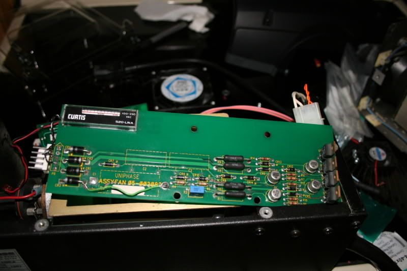

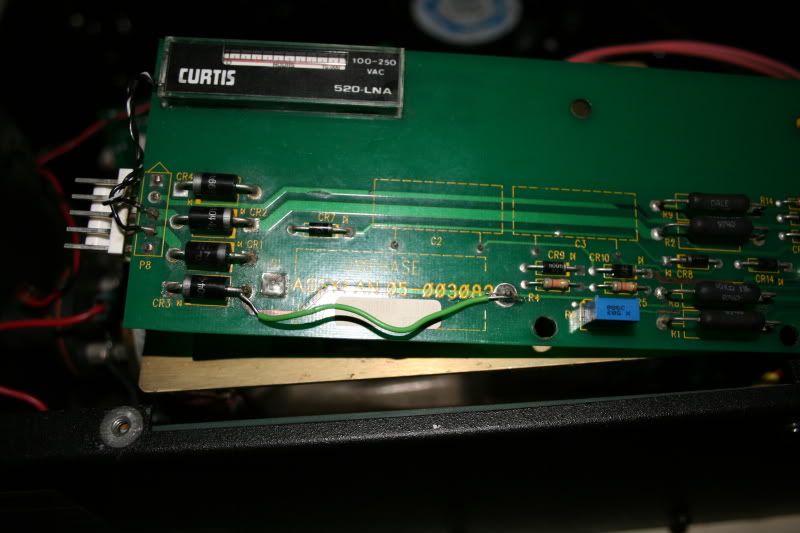

    I've got a 1/2watt uniphase argon laser. Just picked it up with a smoked fan board in the laser head.
    looking at the board there's just a 120v input, and a 120v output to my fan motor. The fan motor still works. I took the fan board out and ran 120v straight to the motor, powered it up, and the laser still works great.
    I dont see any sort of heat sensor on the fan board. Anyone have an idea on what this thing is actually doing? I'm tempted to just run a separate power line to my fan motor, let it run wide open, and call it a day.
    Anyone see an issue with that? Or is the argon supposed to run at a certain temp. In which case, I should get a thermal sensor and wire it into my fan.

    here's a few shots of the fan board

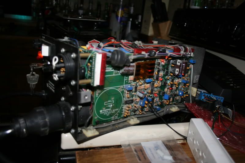

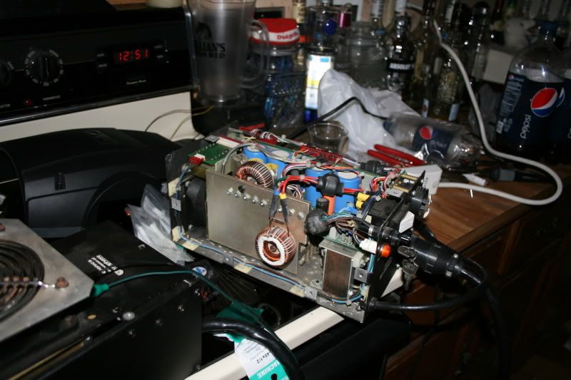

    and another of the PSU, just because it looks awesome
    yes, it's on my stove, haha the g/f is outta town and is going to kill me if it's there when she comes back!!! along with the rest of the bottles from the party's this weekend...opps...anyone wanna help clean?
