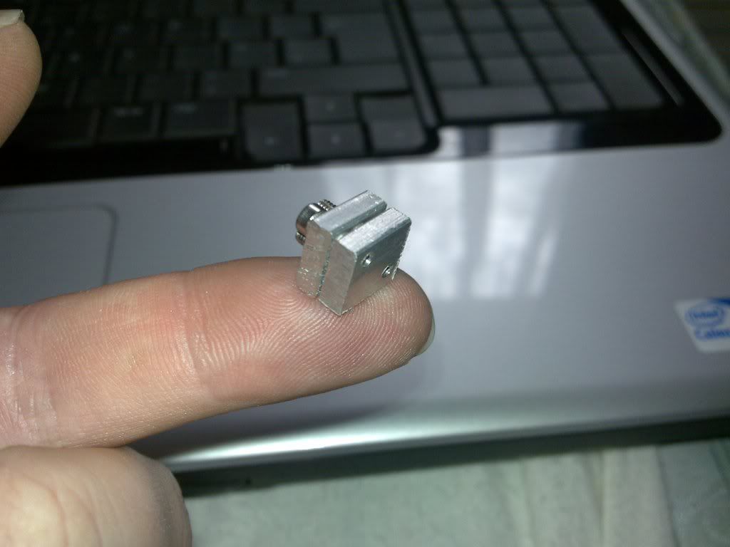

    my new mini mounts
    8mm by 9mm by 7mm (or 9mm if you include the screws)

    that's some nice engineering. are you concerned about providing enough heat sinking for the diode?

    what do you mean sorry? what does a mirror mount and heat sinking the diode have in common??

    oh, my bad. it means i haven't had my coffee and was mistaking your mirror mount for a diode mount. sorry about that!
