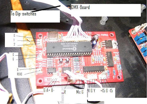

    Lots of thanks to 2nd17th for his board.
    We are trying to figure out how to connect all stuff and we figured out most, but there are two mysterious connectors left: one labeled "G REVS" and one "G A+ B-". If you know what those mean, can you please tell me?
    All other connections are more or less connected.
    Other problem: I don't know how much voltage the laser driver needs. The original board needs 9V and the laser driver is powered directly by the board, so can I assume the laser driver needs 9V also or am I just gambling? If anyone knows the right voltage, or if there is a standard for this, please tell me. The laser projector is... err was ... a Performer 40 mW laser from Koollight, cheap Chinese.

    Hey Steve,
    thanks for your interest, but I got all the components I need. I only need some help with cabling. 2nd17th wasn't very carefully when he ripped his board out and now we are puzzling it together again. I figured most of it out, except "G A+ B-" (maybe it has something to do with ILDA?).
    Me on the other hand wasn't very carefully when I ripped my board out and no I have no clue how much voltage the laser driver needs. It seems like I have to reattach the transfo and reconnect the wires after I ripped it all apart. If it was only 9V, it was no problem but now I have to work with loose cables with 230V...
