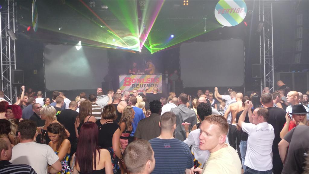

    The stand is quite good, for big set-ups. Will it fit on your car? What about if you have 3 projectors?
    Taken last Saurday, my 3 projectors, 1 tripod, brought to the event in an Audi A4.
    No wobbling, 60k sound and no vibrating fuzzy beams, still square on the bounce mirrors 60 feet away after 6 hours.
    No problems, promoters happy, paid in full with thanks.
    As already stated; I wouldn't use it on a timber floor.

    why you did't use the truses on the left and right for 2 projectors, leaving the center with only one?

    Looks great Doc! I have to ask... were you part of a DJ forum like say 10-15 years ago or so. I remember a member "Doc" who talked about his lasers. Just when I started to gain my fascination for them
    EDIT:
    Adrian... although Doc could give you a definitive answer, I'd guess either the promoter/client wanted it that way -or- the truss is from a seperate company (sometimes they are finicky about letting other people hang of their gear) plus you have to work on their time and dont want to wait for them to tear down towers so you can get your gear -or- maybe a system limitation cable length constraints -or- (finally) personal preference, I think it looks really good! Doc, I like how it really draws your attention to the DJ booth, after all that is what the show is about, the DJ.

    Quote Originally Posted by Adrian Cavaleru View Post
    The trusses are part of the venue's fixtures, I had a 1 hour window to set up, the venue has a scissor lift but I don't have a scissor lift license, UK health and safety law doesn't allow working from ladders except for the construction of scaffolding.
    The venue's health and safety manager certainly wouldn't allow anybody to stack up flight cases to use as a makeshift platform for a laser and neither does BSEN 60825 (or anything else other than their intended use for that matter i.e. safely transporting equipment).
    This venue is owned by a university, universities take health and safety *very* seriously, as do I.
    @ mliptack; I have been active on the DJ circuit for for over 15 years, but I have only been active on DJ forums for maybe 8 years and only been operating lasers for 4 years so it must have been somebody else .
    Thanks for your kind words about the setup
