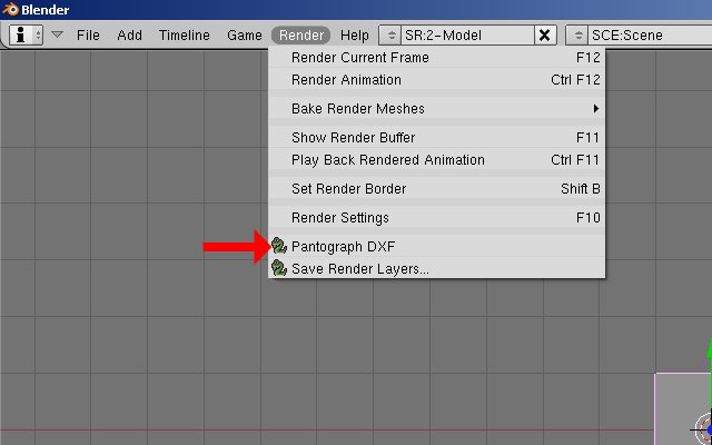

    Here is quick step-by-step tutorial:
    Start the vector renderer:

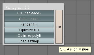

    Just click ok (use the default settings):

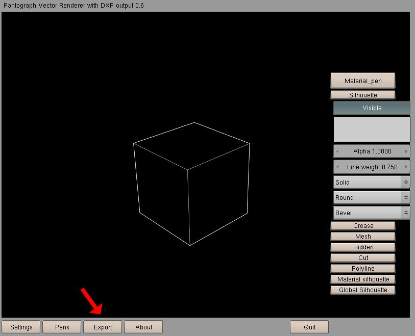

    The gui of the renderer, on the right are the various options for a specific material, use the "Export" button to save the image/animation:

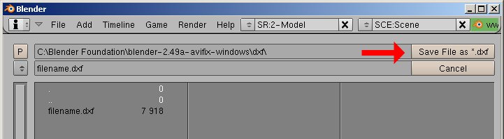

    The script asks about the output format, we will use dxf:
    Select the filename and the path where the file(s) will be saved:
    After pressing the "Save as *.dxf" button, you've to choose if the renderer will save a single file or the animation.
