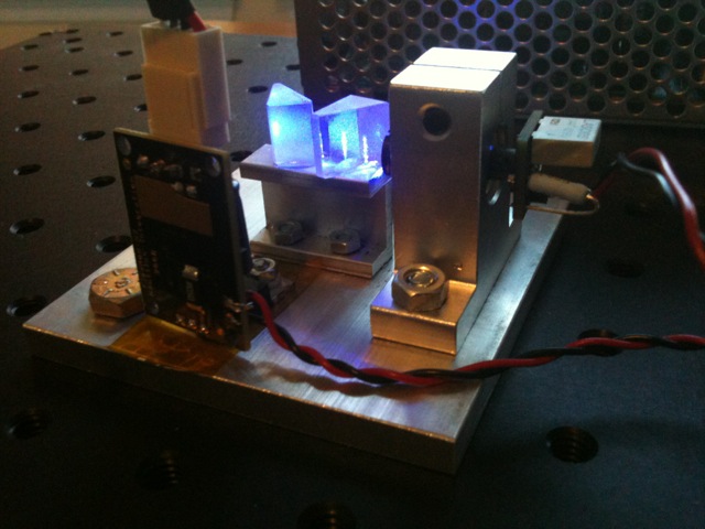

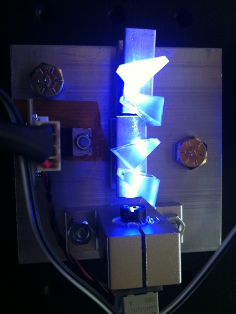

    Excellent work Edison, and NO you are not hijacking the thread - it's really good to compare results between all of us
    I have made a right angled bracket arrangement now but am awaiting the setting of the epoxy resin for the 2x prisms. I have no further time tonight to go any further with it so will have to show some beam tests tomorrow night
    Pics below of the bracket in position and then the 2x vertical FA prisms in situe, waiting for the glue to harden.
    I guess it is my Aixis 405 lens in front of the diode causing this but if I remove all the prisms and just shine the beam onto my shed 5 meters away the stripe is horizontal. If i then project the stripe onto something 100mm or so away the stripe is vertical!
    It changes from vertical to a horizontal plane at around 2M away from the lens????
    This means my SA correction is done with my first set of 2x 'laid down' prisms and the FA correction is done with the last 2x prisms on the L bracket.
    EDISON - I SEE NO LASORB ON THAT 445!!!
