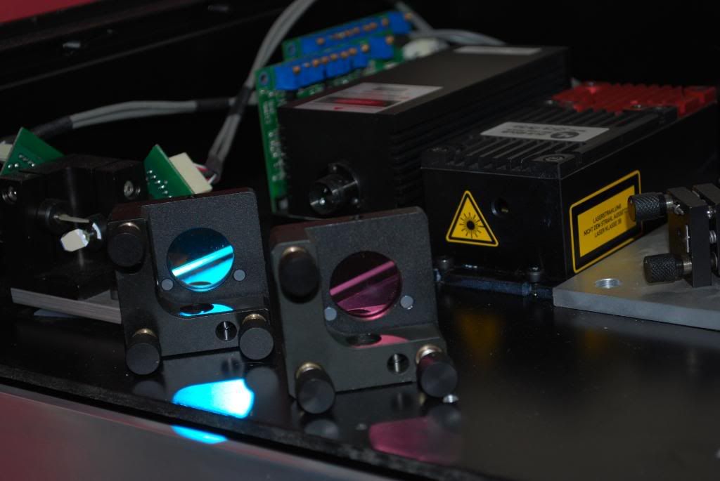

    I consider to make a small change in the position of the lasers.
    Blue First then the red and green to last

    I personally think that blue closest to the scanners is best, then Red, and green last !
    Ah.. actually that was what you did say haha
  3. #63
    Cairns, Australia
    1,896
    Having blue closest to the scanners is a good idea, you don't loose as much power to the optics then, and you need as much blue/red as you can get

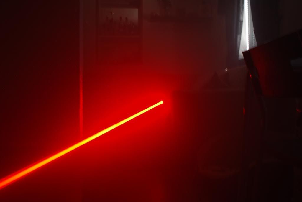

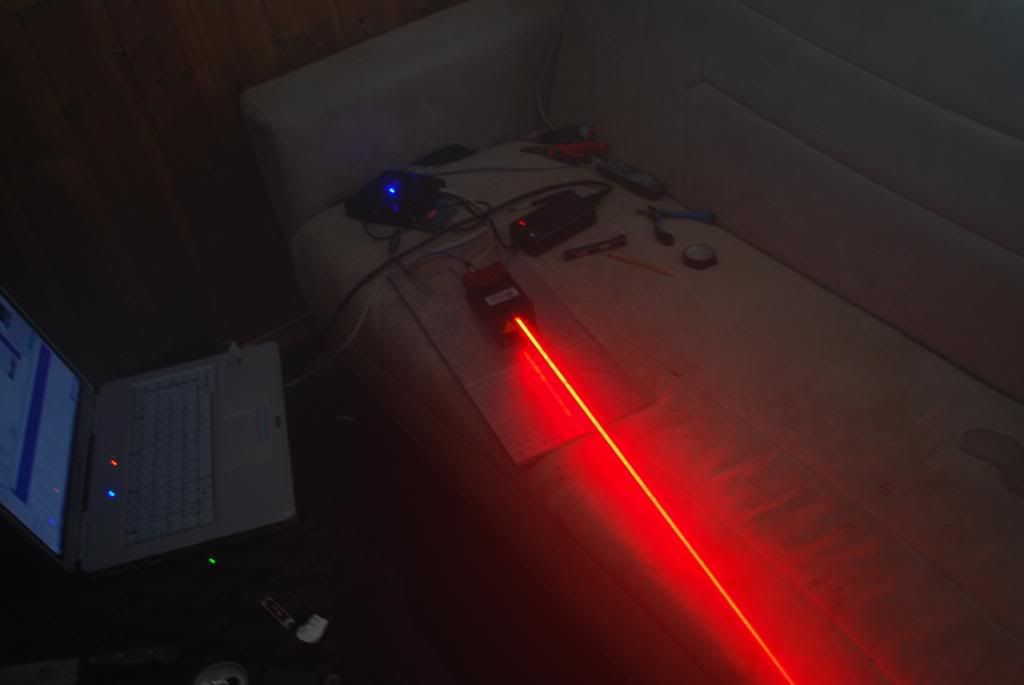

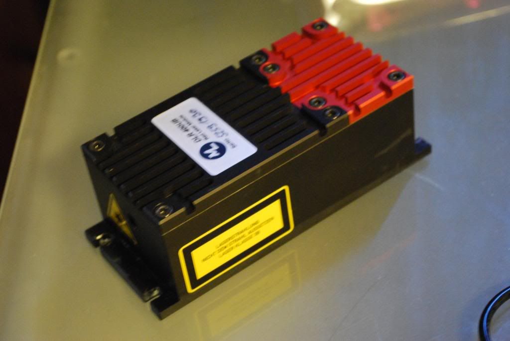

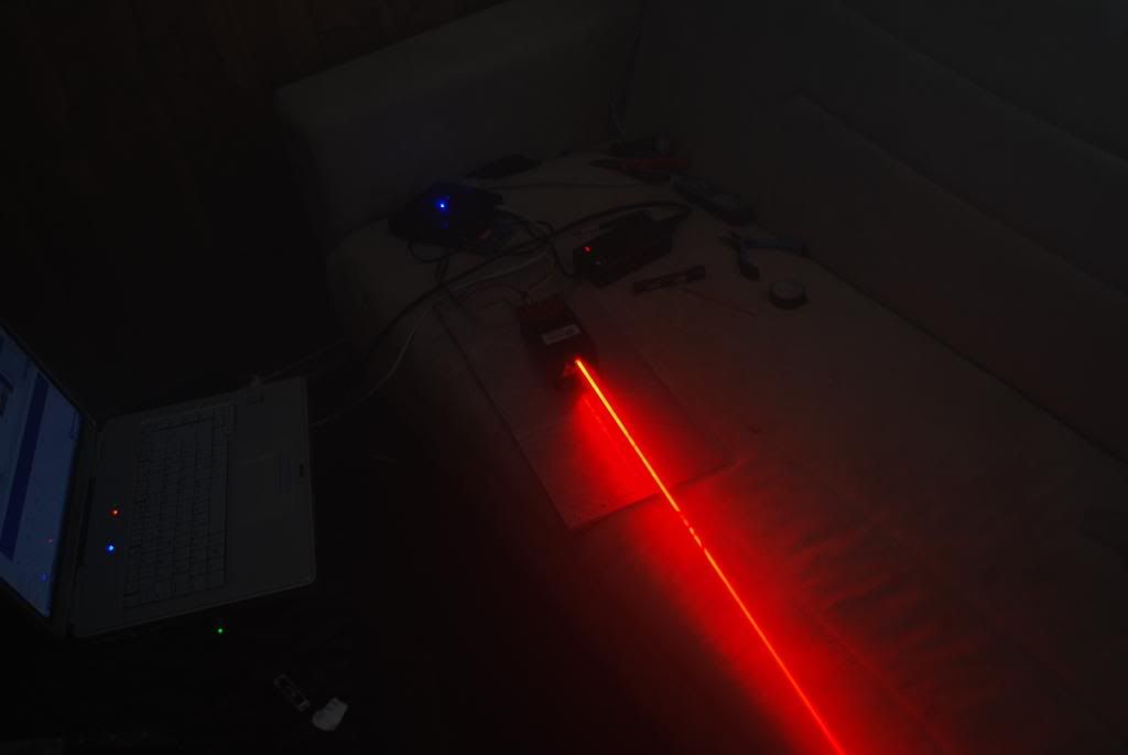

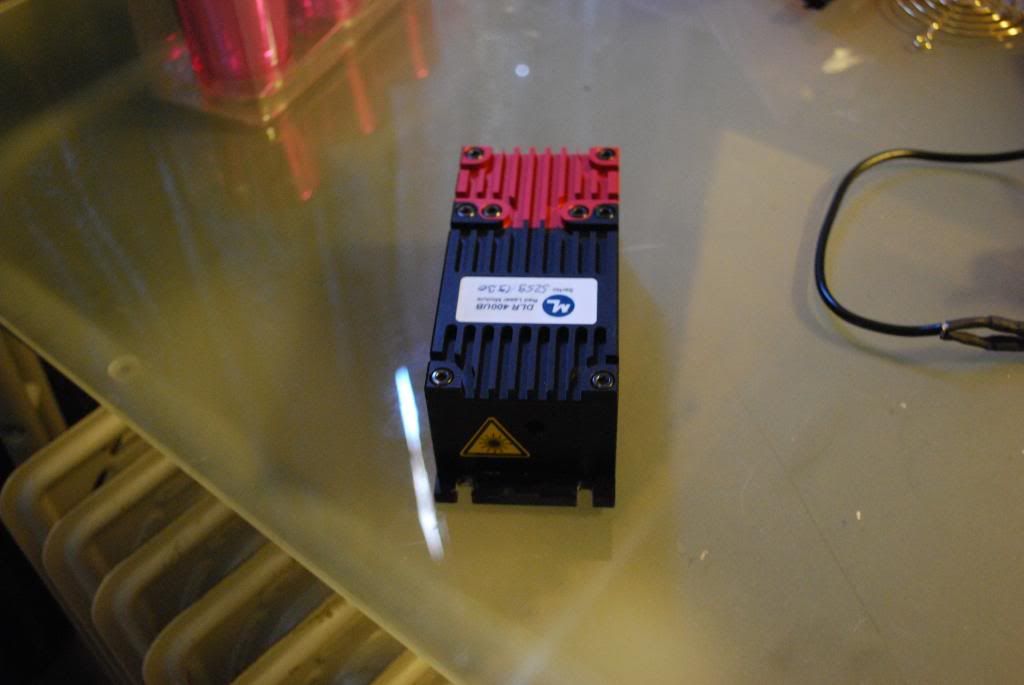

    Recived the red medialas laser today
    All i need now is a 660/637 dichro to combine the maxyz modul to the medilas.

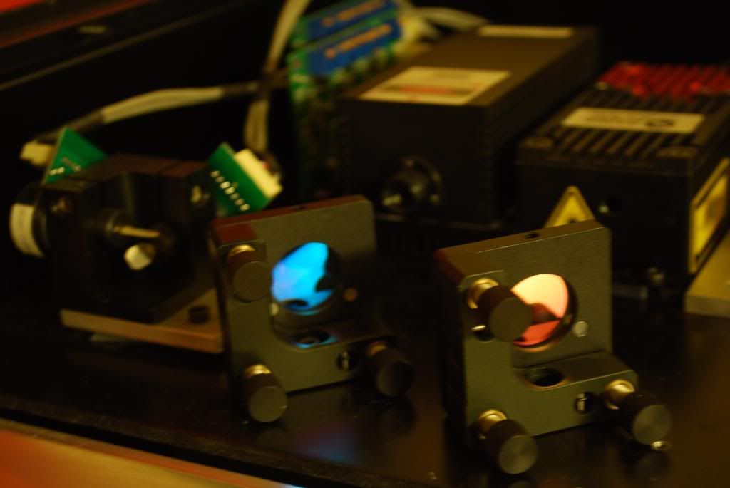

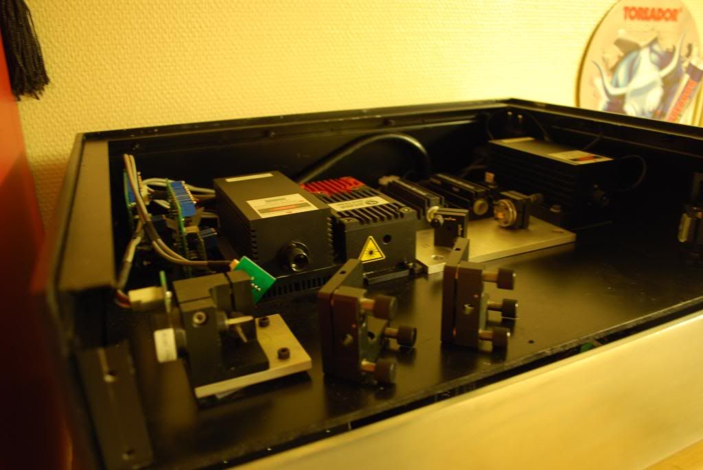

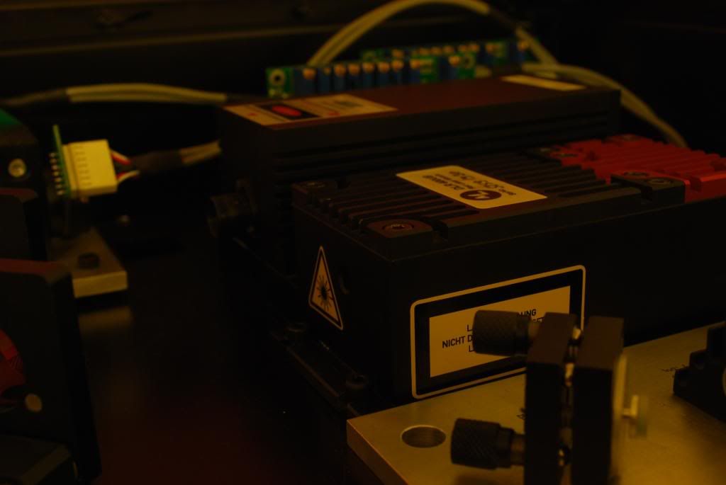

    New Laser setup
    LaserWave Blue 300mW first, then the Red MediaLas 400mW And 400mW Maxyz Modul. And the green LaserWave 500mW..
    Still Waiting on the Custom Dichro for 640 / 660 Combine.
